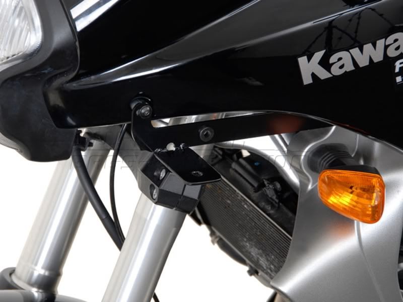

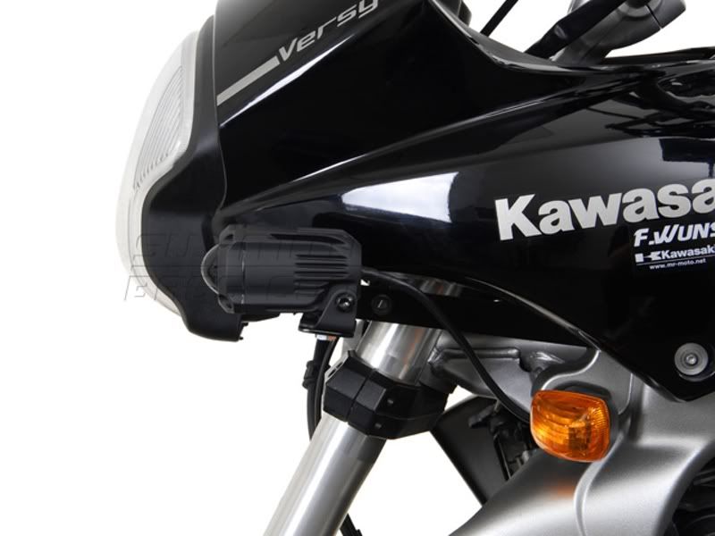

As the dark nights are rolling in now, I’ve bee looking to add some additional lighting but have been thwarted by the lack of high level light fixing positions available on the V. :(
BUT now I have found these are now available from SW Motech :clap:
Both for the Mk1 (07-09) and Mk2 (10- ) V’s
Mk1 Details CLICK HERE
Mk2 Details CLICK HERE
It looks like they also may be able to take other equipment such as Video Cams as well. :thumb:
