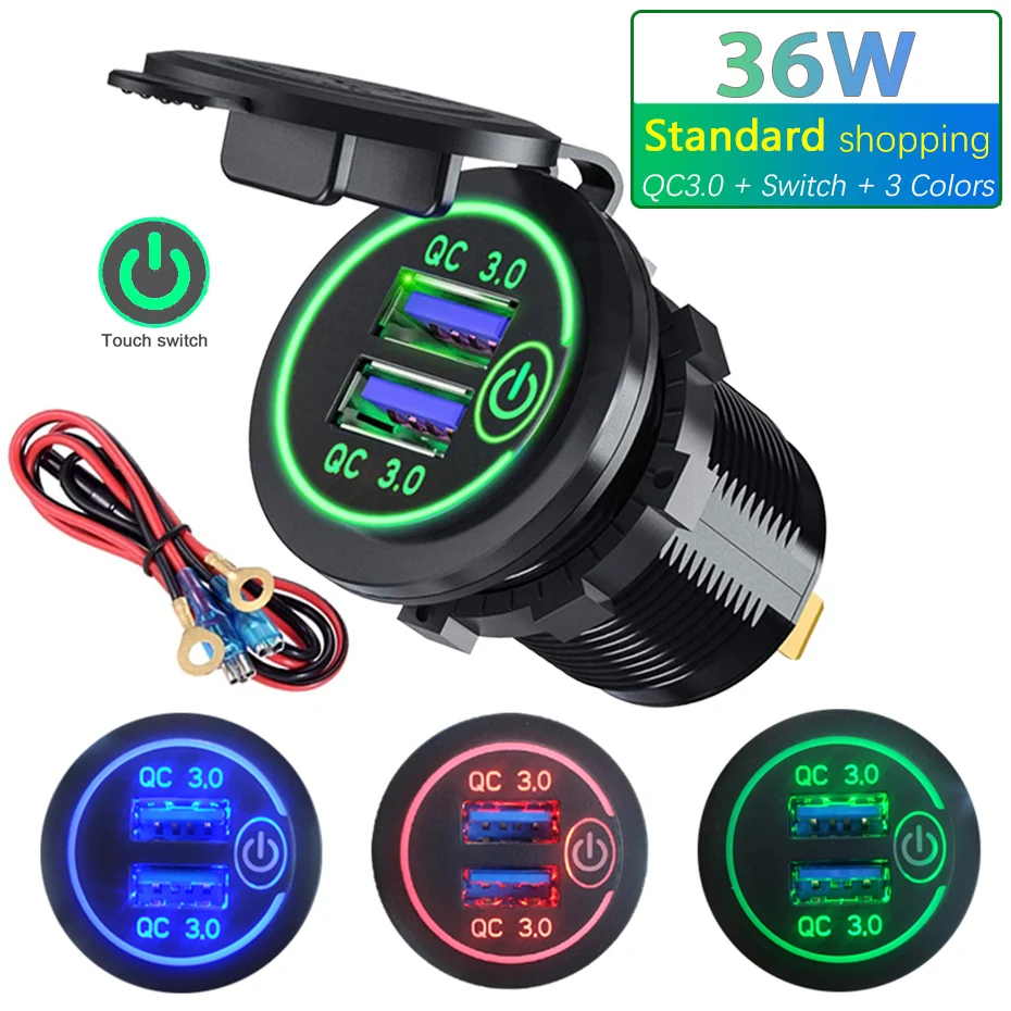

#6 ·
Original USB outlet are to expensive, you can have USB outlet for 1/5 price of original, and even more cheaper
For example,
I have this USB outlet from aliexpress:
You need to buy relay which @Kevinj add in link in second post. Without relay your accessories like heated grips, fog light, USB outlet will not work. You need only 1 relay for all of that.
Also avoid to connect accessories directly to battery, it will drain your battery.
Also here is video to see how to do that job:
