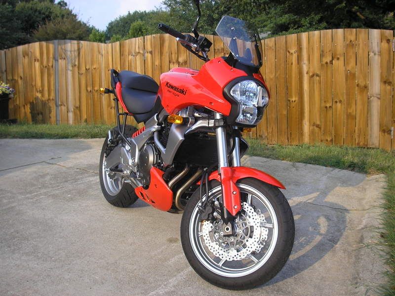

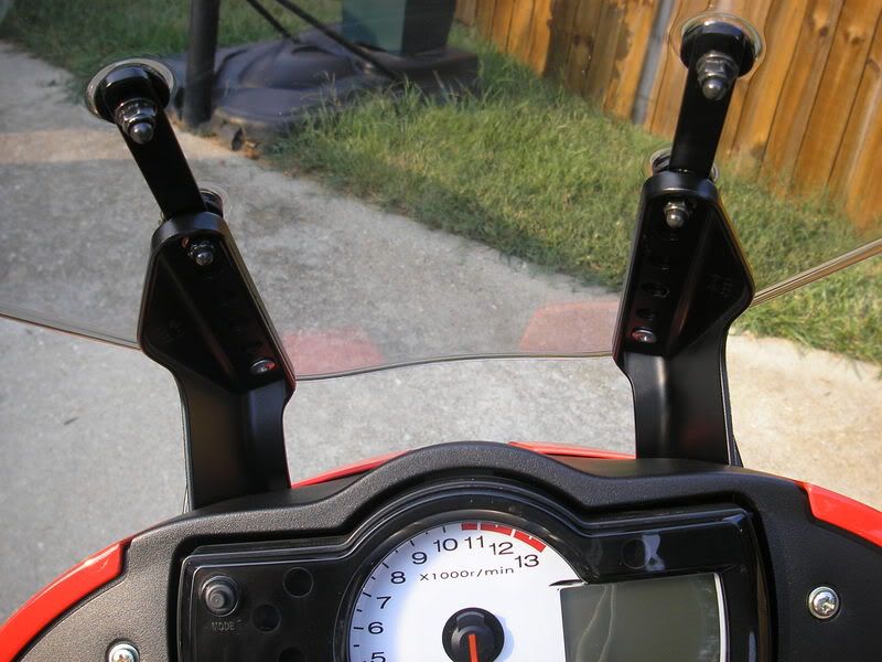

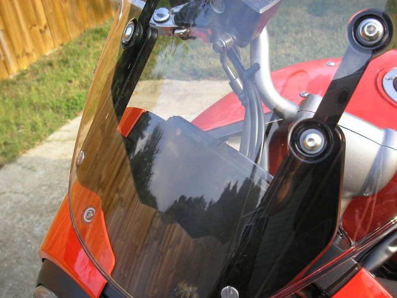

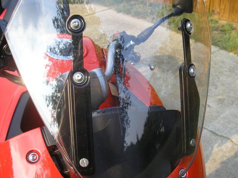

I got tired of the bobble head effect I was getting at highway speeds in heavy traffic so I raised my windscreen. I cut two pieces of 1/2" x 1/8" aluminum flat stock to length. I attached the bottom of the aluminum piece to the bottom hole of the windscreen bracket with a 1/4" aluminum binding post. I then drilled the holes needed to attach the windscreen. The button head screw that attaches the bottom of the windscreen to the bracket is slightly longer than stock to accommodate the extra 1/8" aluminum piece. The top button head screws fastens the top of the windscreen to the aluminum extension. When drilling the holes I clamped both pieces together and then painted them satin black after rounding the ends.
It eliminated 95% of the bobble head effect. It doesn't put my head in exceptionally clean air, but I didn't spend the bucks on a new windscreen either. Besides, one of the things I like about the V is it's sports car characteristics. If I wanted a smooth touring bike I would have gotten a Goldwing.
