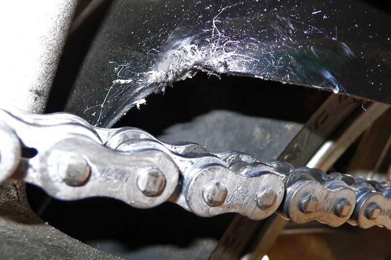

Got a Pyramid Hugger from Amotostuff and finally got around to the install with a new chain at the same time.
It all went swimmingly until I noticed a wierd grinding noise which ended up being the chain grinding again the Pyramid Huggers Figreglass... see attached pic.
It's certainly nothing half an hour with a dremel or file didn't solve but still it worth looking out for! Before you set off on your post hugger install ride, flex the chain up and down to make sure you have more than a couple inches of play between the plastic and links. :yeahsmile:

THe hugger itself is not bad at all. The fibreglass is good and the paint job is consistent. It's simply a problem with the shape they used not taking into consideration enough chain clearance and the problem can be fixed very easily.

I had a Pyramid hugger on a Bandit1200S which was a perfect fit and quite affordable to boot. Maybe they'll change it for the V but maybe not and if you feel the extra hundred bucks is worth 20-30 minutes of your time then you're obviously a richer man than I!
