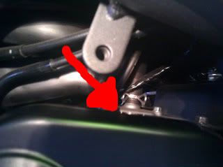

Top of Engine?

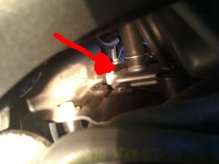

Under airbox?
So which one are we blocking when you mention the pair valve mod? Also, why do you need to take the tank off to get to it at either location? Just to make sure I understand all you need to do is block/cap the nipple and plug the hose, right?
8,000 Posts
PAIR valve is on the engine's valve cover. 2nd pic show the crankcase vent. Removing fuel tank gives you better access to PAIR valve and hoses.
