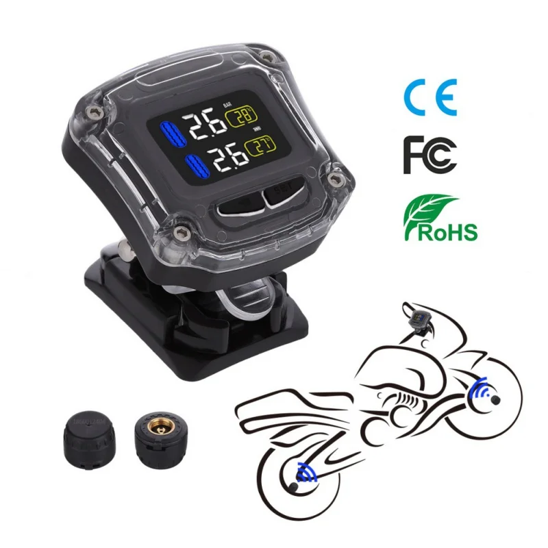

Well I think I am well over 14,000 KM on the rear and front, one thing, I installed a tire pressure monitor over a year ago, it was said that if you have more than 10% increase in pressure from cold to hot, pressure is too low. I have the givi V56 top case and Trekker 33 side cases, I am carrying about 50 LBs including the weight of the cases. With gear total weight is around 255 LBs. I start out with a full tank of fuel, I top up at home to the filler neck, this saves me a stop, most rides are 330 KM minimum to up to 980 KM per day, most rides in May and June were 430 KM around Grey Bruce Ontario.. I run 38 front and 42 rear, my hot pressure is around 41 and 46LB, so within the 10%. I will check mileage and post some photos later.

As bill mentioned 9K miles is 15,000 Kilometers . My bike is lowered with Speedy lowering link, the front is lowered as to his instructions. That TPM is key and it is unbelievable, pouring rain , charge twice a year, the least vibration turns it on, and lack of turns it off. I figure I have another 1000 KM left on the tire but have one on order .I owe this info to @quexpress see post 28 about the 10% rule Tire Pressure Monitoring System / TPMS

Post 20 shows my tire pressure monitor. The rating on my rear tire says 42 PSI COLD and that capital lettering matches what is on the tire, I think some people don't pay attention. So going back to my 07 Versys 650 , my Michelins lasted less than 9000 KM, I was told that 32 and 36 wasn't enough. So with my 2015 I was running 36 and 40. After I installed my tire pressure monitor and @quexpress did a post on the 10% rule , I bumped my pressure up to maximum. That hot tire pressure never changes except when we are near 6'C , then I lower it as they don't warm up as much. But even when the pavement is at or above 34'C , the pressure never goes above 10% , so 46 hot is very common for the rear. My front is normally 40 to 41 hot ( this is at speeds at or above 100 KM/HR ) at reduced speed for extended periods, say 36 KM/HR both front and rear drop to 39 and 42 to 43. I am now seeing the rear lose air, I suspect that I am nearing tire failure as the center is down to the wear strips.
#23 ·
as I live in hot climate, i decided now to put 41/35psi. does it sound about right. by the way, does the TPM from Alibaba has the battery outside or inside the tire? I would not want to have to open the tire in order to change batteries.

The very best investment I ever made was that tire pressure monitor. Hard to believe but a charge lasts more than 6 months, vibration turns it on and lack of turns it off. I think the cost was a bit more than a tank of gas . I think I have over 10,000 KM on that monitor . i was concerned about the senders coming off, been over tons of rough roads, no longer think about it. No question something is going wrong with my rear tire. Losing 3 LBS while the front remains the same, indicates something wrong. And not the sending unit.

it is good to know that the TPM from Alibaba is reliable. I ordered 2 sets for my two Versyses.
I see on another website similar, even cheaper units, not sure if equally good. with Chinese stuff it is often hit and miss.

onewizard, thank you. i ordered before from the same link. it is supposed to come with DHL so hopefully not taking too long.
