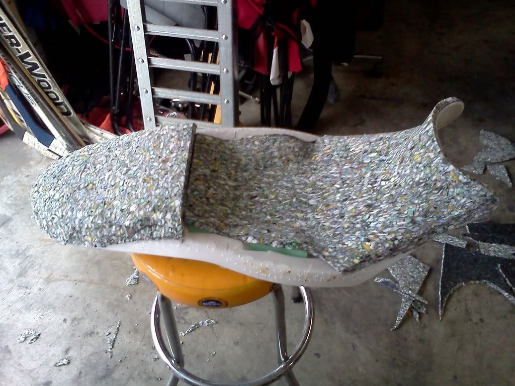

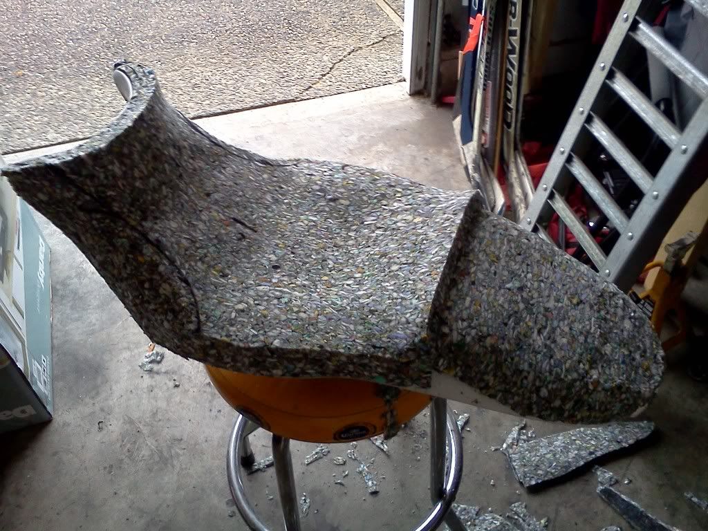

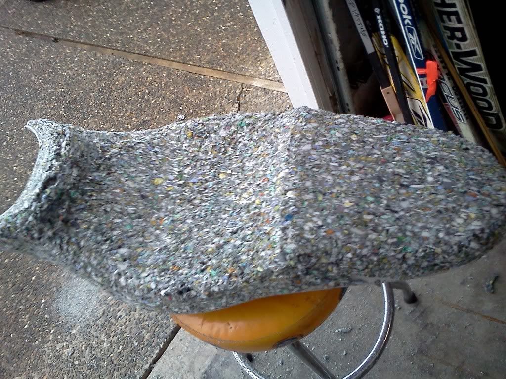

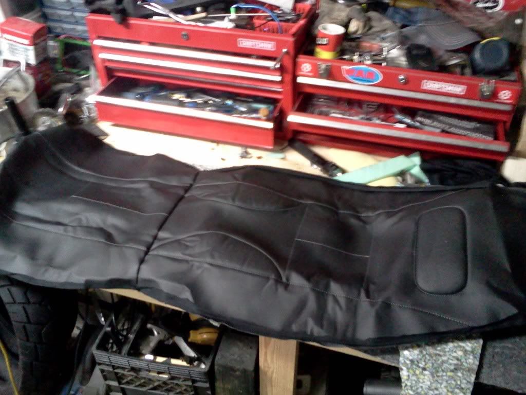

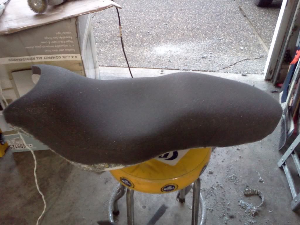

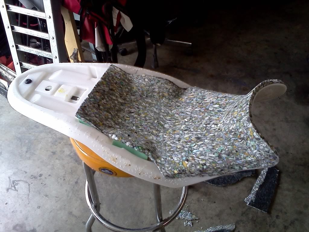

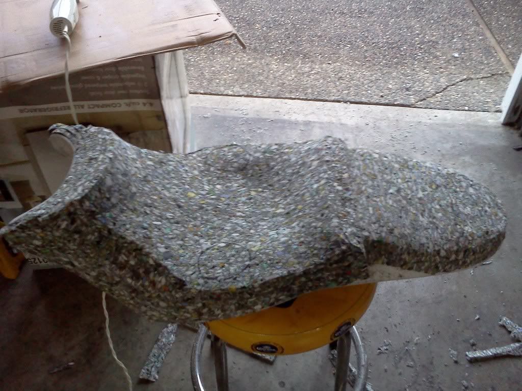

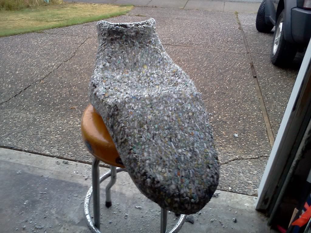

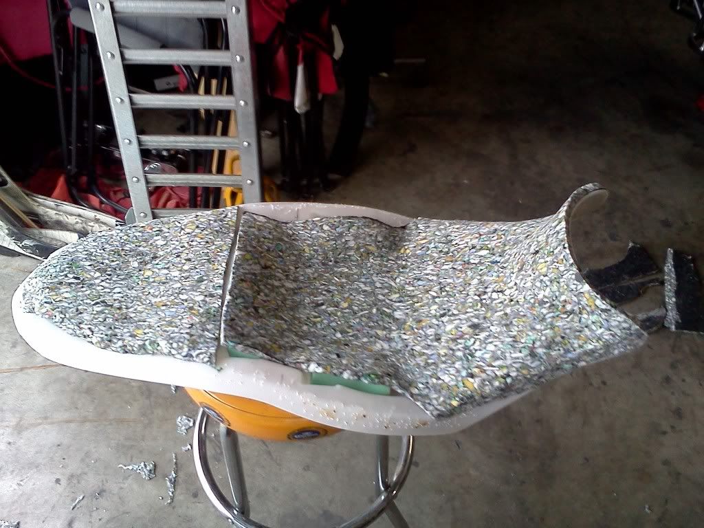

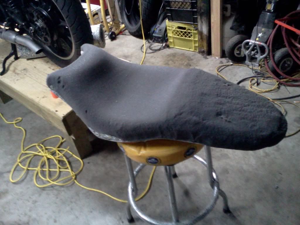

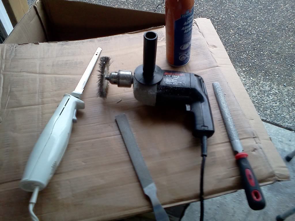

Well, cut some foam and put in on the stock pan. Couldn't take it anymore and after rebuilding a seat for another Versys owner I decided to shape one to match my butt. Feels comfy enough but I have a ride south next week and a couple 500 klm days will tell the full story. Here are some pictures from start to finish with a shot of the only tools used minus my staple gun and a razor.
Full price was $20 for the car seat cover and another $20 for a 6'x6' sheet of foam. Oh yeah, another $4.45 for the comfort foam top layer. Cheers.

Thanks a lot guys. First little ride today coming up in the rain but will let you know after some real miles if I'm going to have to adjust. One thing for sure is my knees will like the extra hight.

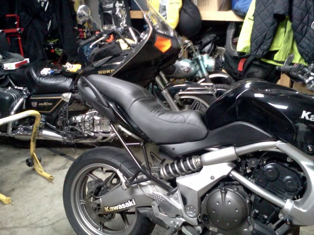

The seat is pretty cool, but, I'd like to see some pics of the other toy in your stable too. What is that silver thing behind the Goldwing?

I'm flattered but I didn't make it. I just used a car seet cover. You just have to centre, stretch and staple. Cut off the extra after attaching.

Just got back from a two day trip through some of the best riding roads I've ever been on. The seat needed some alterations in the horn area seeing as it had a bit of a high spot. After taking the cover off I needed to take off the comfort layer but as luck would have it I couldn't get it off in one piece. Oh well, tore it down and rebuild with a less dense foam for the top layer that in hindsight was a mistake but the seat held up great the whole trip. Just the usual aches and pains that go along with sitting that long. Here's the route.

So, with winter riding coming up I thought it prudent to change the seat cover to make it water proof. Just some thick vinyl. Also took the opportunity to tweak the shape and add a different comfort layer seeing as I had to destroy the one attached to get it off.
