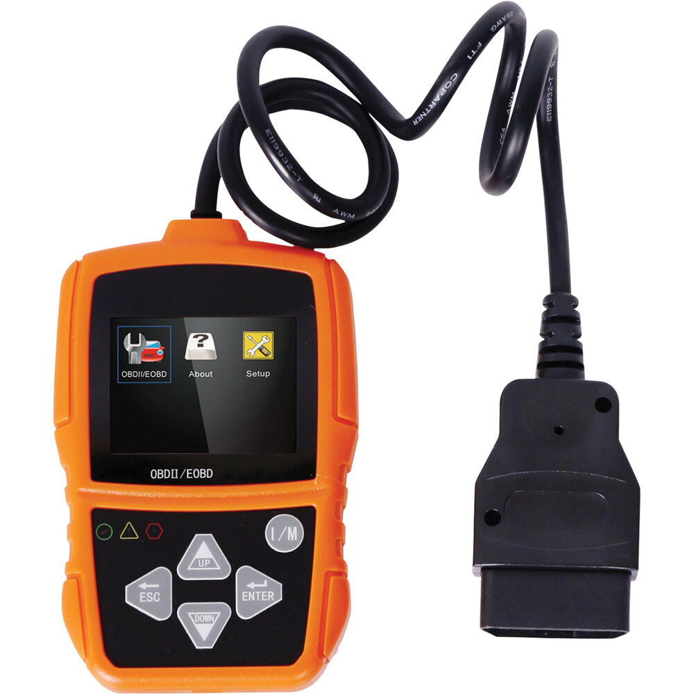

Seeing that no one popped in with a way to see an error code via the dash display, with my Ninja 1000 it needed the User to have or buy an aftermarket OBD scanner and connect it to the bikes Diagonistic Port connector (the Dealer servicing port). Below is a link to better explain what one looks like, and you then need a Service Shop Manual to find out the codes meaning (or look in Google or here).

Seeing that no one popped in with a way to see an error code via the dash display, with my Ninja 1000 it needed the User to have or buy an aftermarket OBD scanner and connect it to the bikes Diagonistic Port connector (the Dealer servicing port). Below is a link to better explain what one looks like, and you then need a Service Shop Manual to find out the codes meaning (or look in Google or here). Rob.
Cool, this is very useful. Thanks! I will see if i may get one some time later even though seems earlier year Ninjia 650 could find the error code via dash paly, but doesn’t apply to 2019 model.
