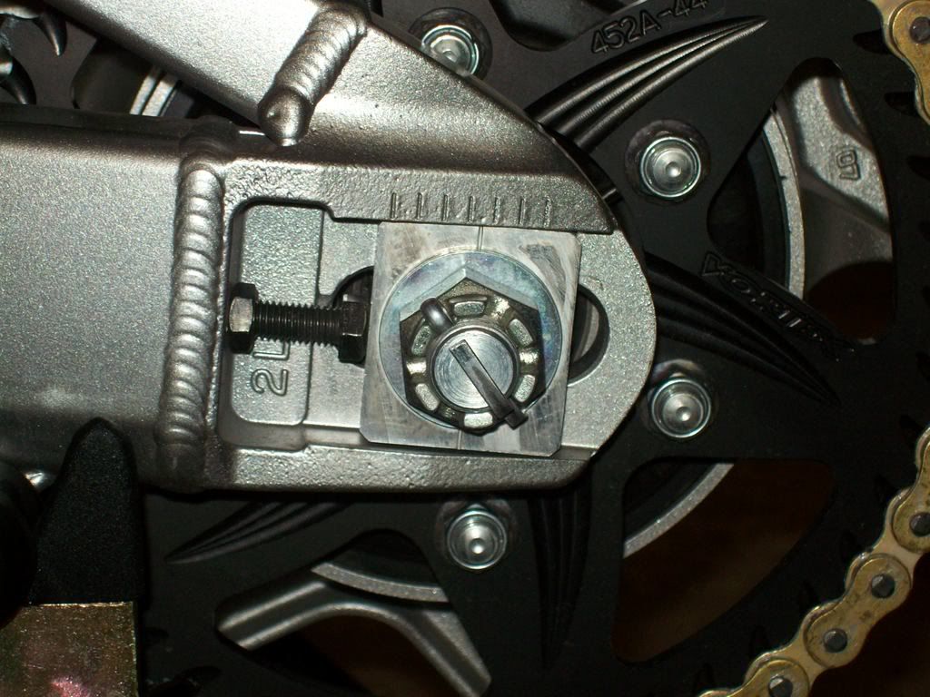

Rather than fool around with finding the 16t dampened front sprocket I installed a 44t rear sprocket. A good rule of thumb is 1 tooth in the front equals 3 teeth in the rear. A 43t rear with the 15t front is nearly the same as a 16t front with the stock 46t rear. I just wanted a little bit less RPM at freeway speed but not to loose the snap of the stock gearing. It is exactly what I was looking for.
Got the Vortex VTX-452AK-44 sprocket and the RK RK-XW-520-001 chain at www.motosport.com.
Take a look.

If you choose not to replace the chain it is fairly simple.
Remove the rear wheel, remove the sprocket nuts, remove and replace the sprocket, torque the sprocket nuts and put the wheel back on.
If you replace the chain you will need a chain breaker and a rivet type master link tool. If you lack experience with working on chains I would recommend that you have that part done at a shop.
