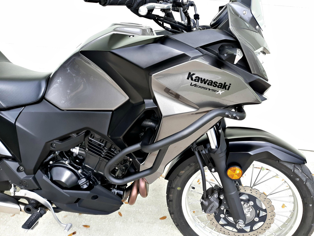

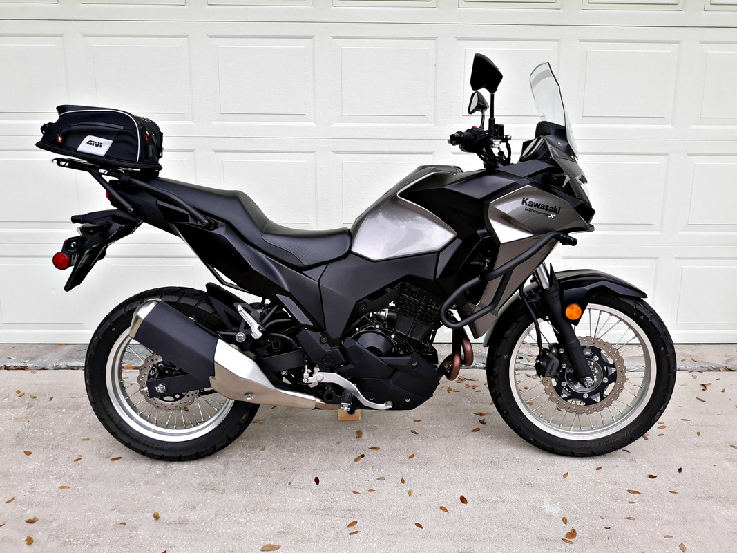

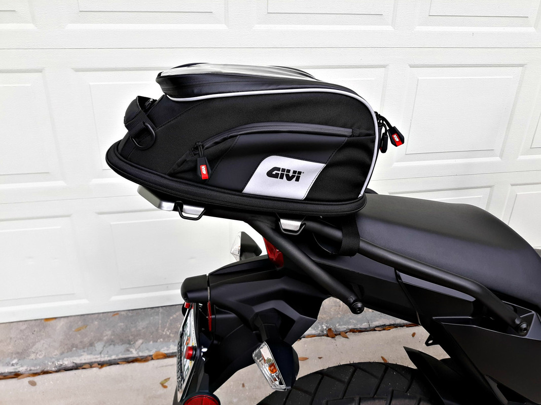

I too did some farkling today. I received the Givi quick release tank bag and mounting ring, along with the Kawasaki crash bars that I ordered, so I installed them today. The Givi 15 liter tank bag is the same model that I use on my Moto Guzzi. But instead of mounting it on the tank like I do on the Guzzi, I bolted the mounting ring to the rear luggage rack so that I can use it either as a tail bag or a tank bag. I'll just use the safety tether back there just in case. The instructions on the crash bars called for removing all the side body panels including the nose plastics and windscreen, this would have taken a lot of time to complete the job.
Using three 5" or 6" socket extensions end to end with a swivel on the end and a small compact ratchet, it allowed me to be able to bolt the front crash bar mounting bracket, reaching it thru the top (going in from the handlebar end reaching downward in the forks cavity well) and bolting the bracket to the front of the frame. This allowed me to do the job in about an hour, allowing me to take a short 25 mile ride today. I'm still trying to decide on which of the skid plates that's available for the Versys X to use, each have their pro's & con's. I was also contemplating on which axillary LED lights I'm going to go with on the crash bars. Yours look great, so I hope you post a link.
