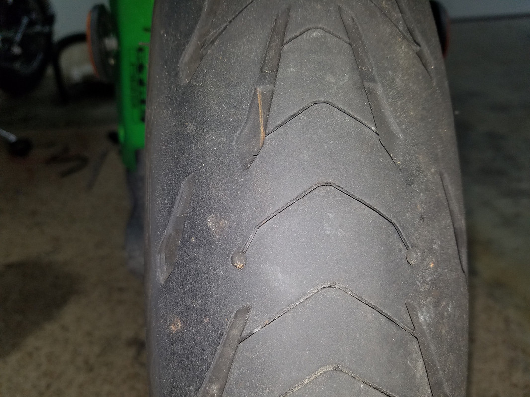

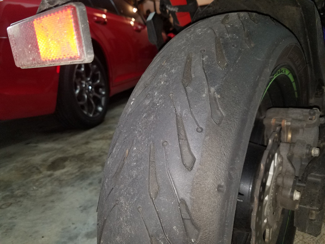

Anyone running these on a V1K..I have a set that have just over 3000 miles on them now and I do not see them going past 4500...
Full disclosure, I ride my bike like I stole it but I normally get between 5500 and 6k out of a set of tires.....
I've run Roadtec 01's and Metzler M7RRs...I was happy with all of them, ... they all lasted about the same and they all wore very evenly..I had a set of PR4 that wore funny and now the Road 5s are wearing very weird...
I am very happy with the grip both wet and dry,they are the best I have used... but I am severely disappointed with the wear and honestly dont see me buying another set

Yeah, mine are not looking too good...I'm running 32/42 as recommended..what pressure are you running?
and these pics were 500 miles ago..Ill get better ones...I have no idea why they are wearing funny...it seems to be a Michelin only thing with my bike.

here are better pics...total mileage 3240
front
rear
Maybe Im expecting too much....but for 350 bucks, Im not at all happy with how these are holding up.

The wear you show kinda looks like something you would see on a track tire. I notice it is on the bands of softer rubber on the sides of the tire. Do you ride in extreme heat? Was it track day wear or a really hot road surface? Just curious.
I've always had good experience with Michelin Pilot Roads but it was for regular street riding with minimal hard cornering. From what I have read Pirelli Angel GT's might be a better fit for harder sport riding.

No track days on these..and it was about 85 degrees this last week which is when 2500 of these miles were put on.
I do corner pretty hard and I was down around NC and Tennessee this past week but I have not seen this wear on other tires I have used.
I do like the way they handle, they stick like glue both wet and dry, so Im not bad mouthing them per say, but Im wondering if maybe the recommended pressures are not right

36/42psi. Thats also what i ran on my V-650 and always got about 11,000 miles out of 2 sets of PR3's

Looks like you are riding on the edge of traction and are orange peeling those tires.
I loved the grip of PR4s but I got punctures on two rear tires and no punctures on other brands of tires. I attribute that to the extreme rain grooves on those tires.
