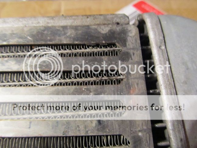

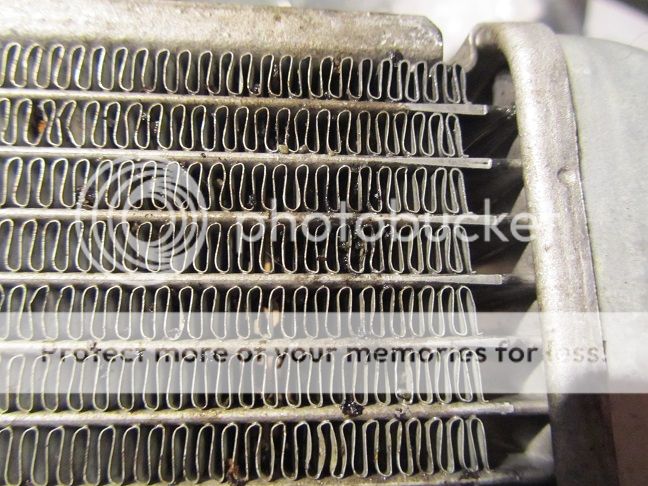

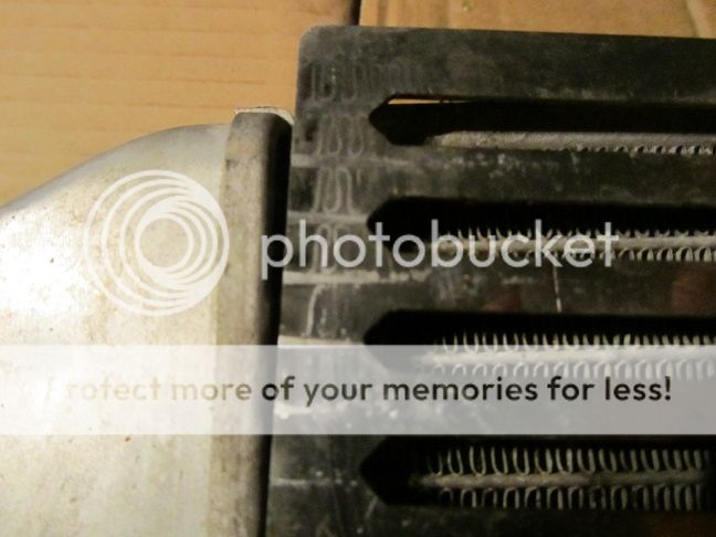

Fitted a Beowulf to the Versys back in 2010 and its fine, fitted a Beowulf for the Ninja 1000 in 2011 and it has warn the top left and right edges of radiator away.
My mechanic rang me up and ask if I was sitting down a he said a replacement out of Japan was $1060.00 NZ but he suggested I look on ebay and ended up with a clone version for $165.00 NZ including freight shipped from Hong Kong, so Hong Kong won that battle.
Test ride on new radiator on nice 20 c day around twisty country roads a success.

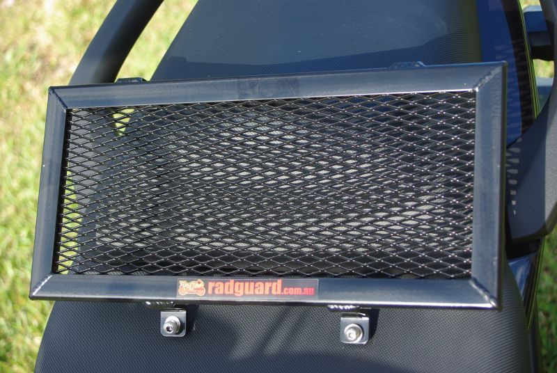

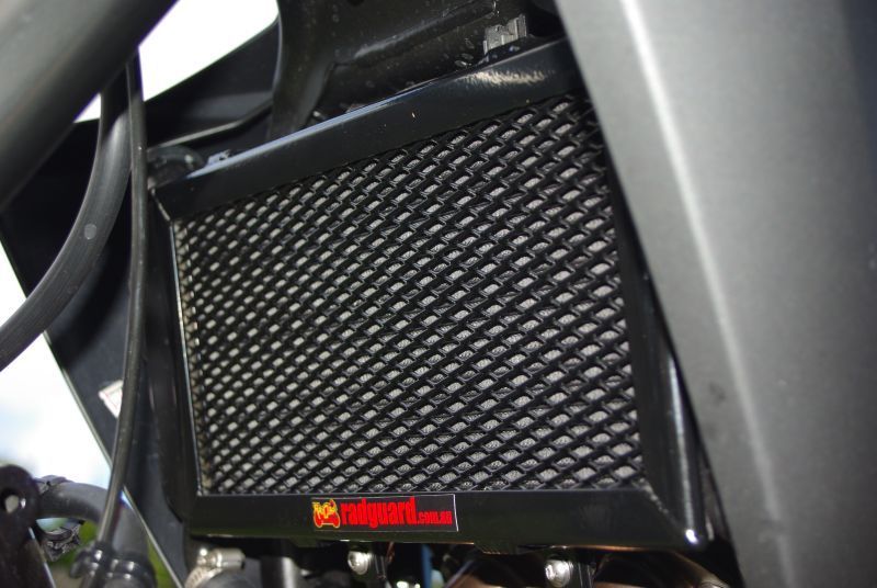

Aussie (Coffs Harbour actually) made RadGuard on my bikes, the Versys has 37,000 km on it now no signs of wear on rad http://www.radguard.com.au/
