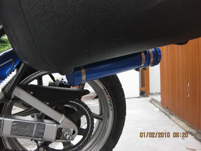

Had a zero speed side trip at the driveway.
Having HB 40L bag, my V rested on the bags first and didn't touch the HB bars.
Few stratches on the base of the bag but not noticeable.
The HB bags wing span is close to 38 inches. (same as the mirrors end to end).
but , (better this than the V's paintwork)
