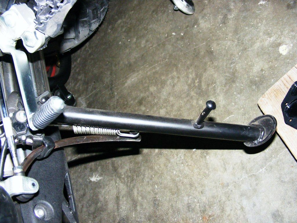

I just got mine from a member here. It's in great shape but it DOES NOT FIT!! The bottom flat of my kickstand is quite a bit bigger than the cut out in the flatfoot.... There is NO WAY this is going to work. Are there different sizes or what?

I was on my way to work and figured I could throw it on real quick before I left so I will have to get pictures tomorrow.
My bike is BRAND NEW and NOT lowered and as far as I can see has an OEM un cut kickstand. The bike is a California model as it has the "bulge" under the tank on the left side for the charcoal canister. But other than that....?
I am FULLY AWARE of what my problem "REALLY IS" I have the instructions and know what SHOULD happen but there is NO WAY I can slip the top plate over the flat of my kickstand. No matter how I twist it.
As I said in my OP the foot of the kickstand is quite a bit BIGGER in diameter than the cutout in the bottom of the Flatfoot. So even IF I was able to magically get the top plate over the kickstand just WILL NOT fit into the bottom plate cutout.

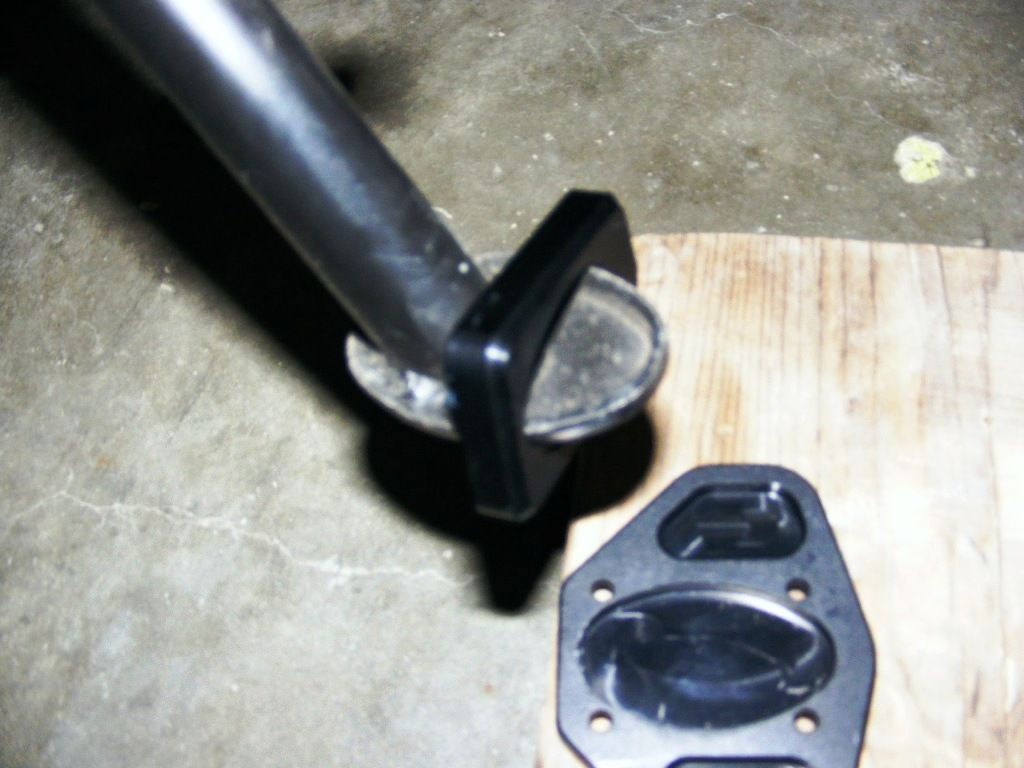

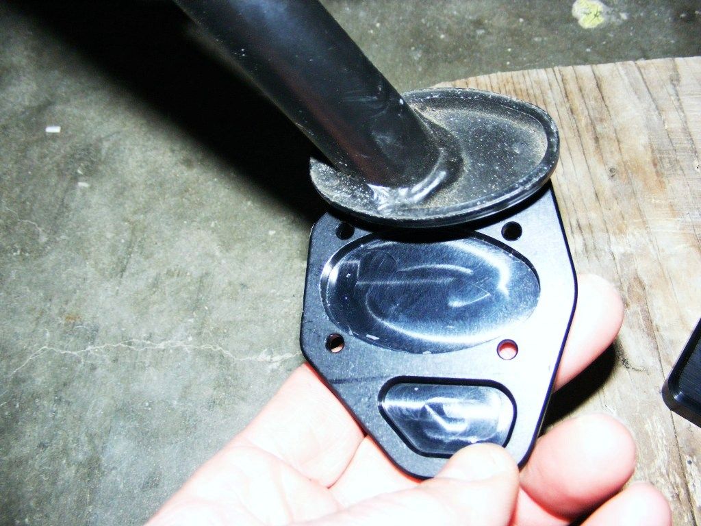

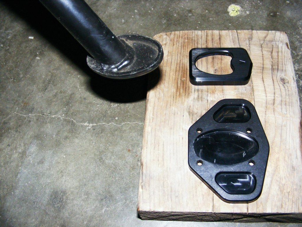

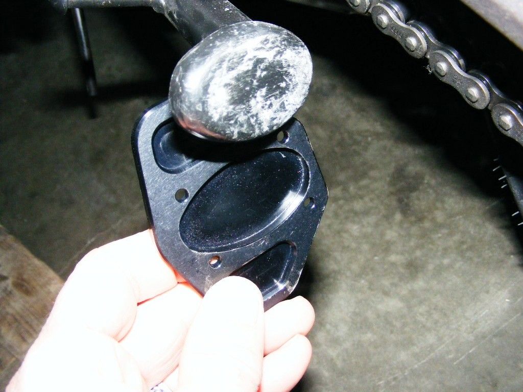

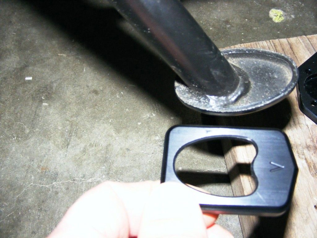

post #7 of 24 (permalink) Old 03-23-2014, 09:37 AM Thread Starter
Posts: 1,271

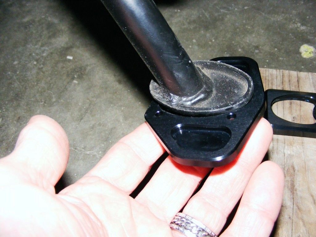

Pictures as promised:
It LOOKS like everything is right:
Then you go and size things up:
Looks normal:
Not Quite the same size?
There is NO WAY that is slipping over the foot!
Not even close:
SO WHO wants to take a stab at it NOW?

I have one too--im wondering if they sent you one that was made for another bike. maybe put it in packaging that says versys by mistake. that kind of thing is bound to happen once in awhile----your kickstand looks just like mine---I cant get the measurements that you really need. the bottom piece is 2and5/8 (widest point) x 3and1/2

but yours is the 10-13 model ?
Maybe the Versys Mk2 lost a bit of girth in the Kick Stand pad?
EDIT: Just had a look at Speedy's store:https://www.kawasakiversys.com/forum...er-forums.html
Have a look at the Standard Flat foot Pics... there looks to be 2 version, a narrow with a "V" stamp and a wide with a "X" in a "V" stamp on the top plate.
You have what looks like the Narrow "V" version.

Isn't your V a 2011? That may the problem... The Flatfoot you have looks like its for a 2007-09... and on the Speedy site there are different ordering options for the following:
07-09
2010
2011
2012
2013
2114

So using the above as logic for sizing, EACH year after 07-09; 10, 11, 12, 13 ,14 are different from each other? I don't really think so. Why wouldn't they be listed as Mk1 or Mk2 OR 07-09 and 10-14? I am not getting it.
I believe you are on to something Gigitt I too see the difference!

Sorry to say but I think you have a Mk1 <09 Versys Flat foot.
That means the Side Stand Oval Base plate is larger on the Mk2 >2010 model Versys.
My Flat foot for 2012 model came labelled:
Standard Flatfoot
P/N KV-FF-STD-10-13
Kawasaki Versys 2010-13
Also I have 'X' inside 'V' stamped on top plate and the width of hole is about 32mm wide at the camel toe.
