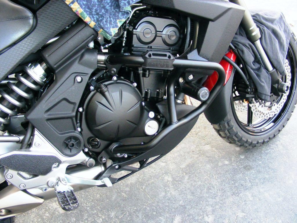

Givi engine guards AND T-Rex Racing Frame sliders conveniently fit together with only slight modification to LH engine guard. Double protection never hurts, right?

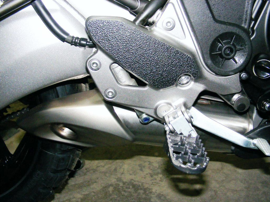

TechSpec heel guards and eBay special DR650 footpegs.
The footpegs needed drilling out to fit the mounting bolts. I also put a steel spacer in between the mounting tabs of the pegs for strength, since they fit along side the brackets of the Motowork lowering blocks.
The TechSpec material came in a sheet and I cut out the pattern I wanted. It took a bit to get it right but well worth it with my big clodhoppers rubbing against them.

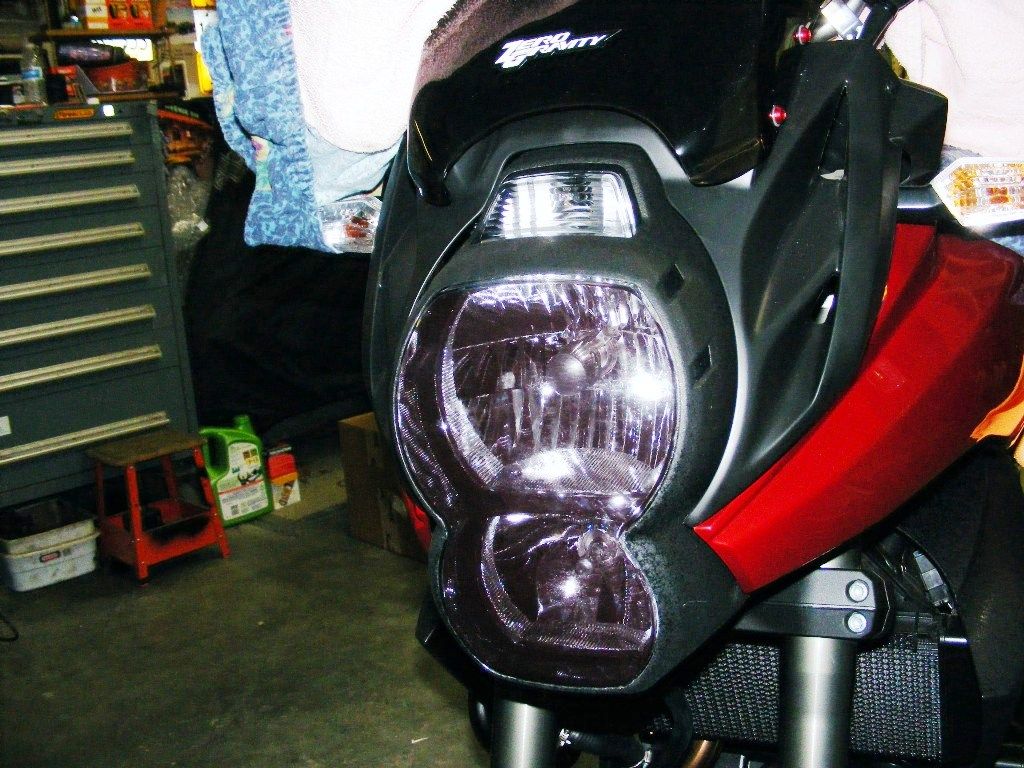

Light smoke Lamin-X headlight protector

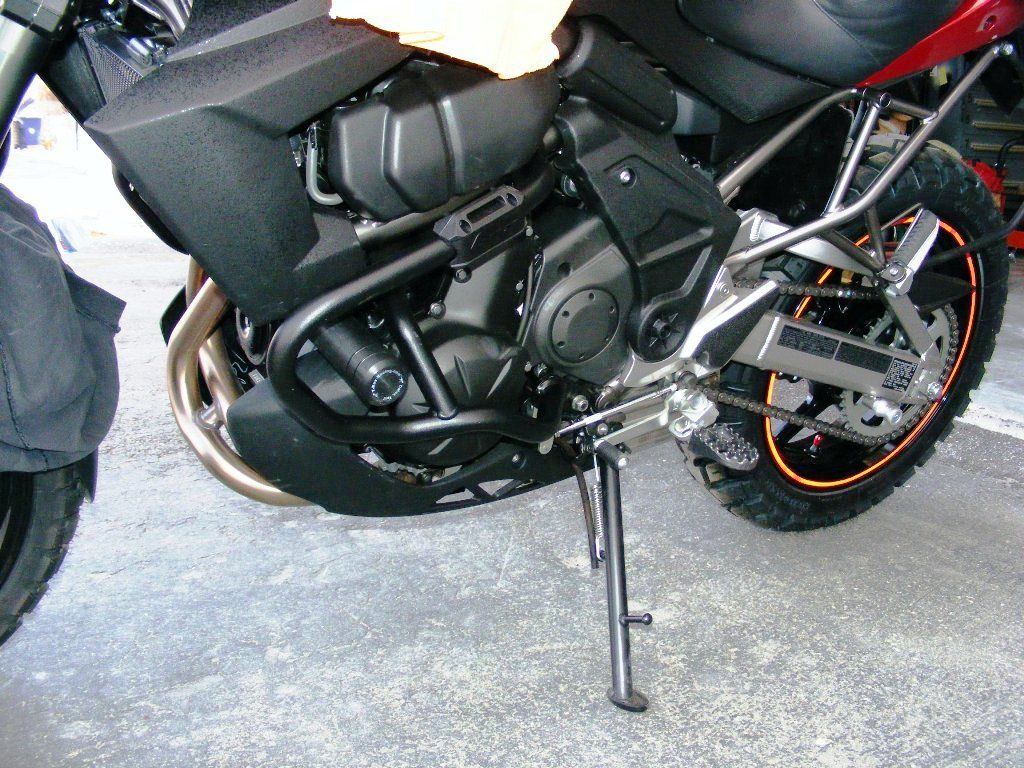

Lastly I fitted these swingarm spools/sliders but they interfere with the Bikemaster Paddock stand I have so they are up for sale if anyone is interested.

dspark is correct I ordered a sheet and cut to fit. I have the templates that I made if you want. And they will accept a decent offer too. Hope this helps
