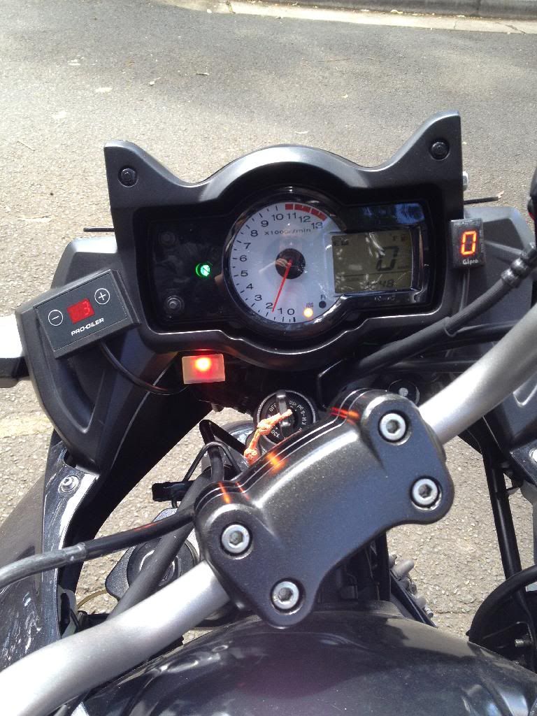

Originally Posted by Snecer View Post
Installed on my V.
Oh dude...so close to where mine is
Also I have a HealTech Shift Light Pro with a diffuser I made:
Gigitt is offline
