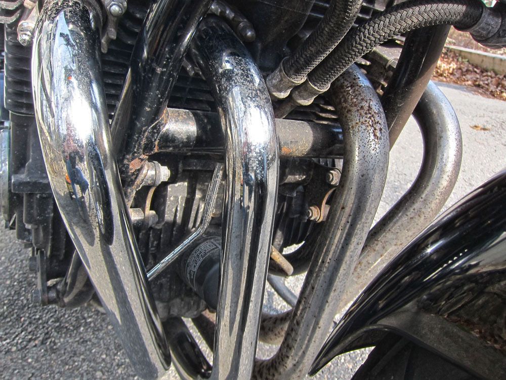

Exclamation Cleaning the headers / downpipe
I purchased some dangerous header cleaner liquid that worked but it was very expensive and sufficient for a single use only. So I researched the ingredients. Similar item contained 15% HCl acid. Here I have been using the 20% HCl hydrochloric acid / muriatic acid /chlorhydric acid. That is cheap houshold cleaner. Warning! It is dangerous stuff, will cause terrible burn on your skin and damage to motor parts! Use it only for stainless steel pipes (not for chrome). Use rubber gloves. Use water to rinse. Motorcycle must be wrapped in plastic (shopping bag will do). Plastic spray bottle is used to spray the acid. A piece of cloth was used to shine the pipes. Then everything was rinsed by water. Even the acid that dropped on the concrete develops gas, do it outside. Gloves are a must!!!

i just took a peace of dollar store stainless steel scouring pad and scrubbed mine down and it looks almost good as new (will take pics later)
didnt need any chemicals or all that bunch work... did make one hell of a mess out of my garage floor tho

all the above works and fine sand paper too... but don't touch chemicals if you are not familiar with it.
I've owned two old Nighthawks and one was pretty neglected. Very fine stainless steel pads did the trick for me too. Just takes a bit of patience.
