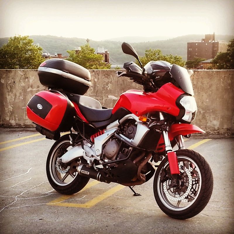

When I bought my V used, it came with all black side bags. They were a bit scuffed up like yours.
I sanded the roughness out of the plastic and painted them red to match the bike. Over the 7-8 years I have had the bike now, I have redone the paint job a few times as I have scuffed it u in the garage or in a tip over.
