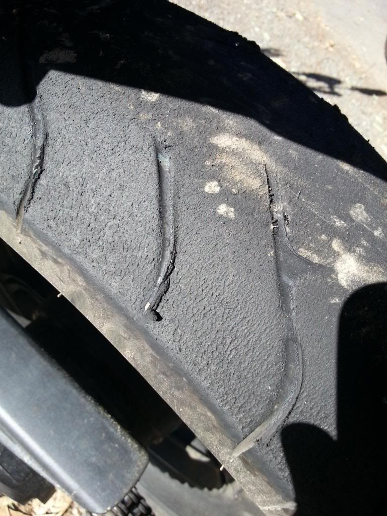

I have 5k on my '15 650 and the rear tire is already squared off pretty good.
The center wear indicators floated away around the 3k mark after a long trip, but the sides are still good with deep tread.
I've ridden about 1000 miles going full blast so far so I know that really shreds my tires, but is this normal? I ride very hard, 0-100 all the time, mostly highway.
Do the better tires resist this kind of wear better? Are the stock tires considered to be good or just 'stock'? Really feels like the stock tire didn't have much tread on it to begin with. My friends 'nice' tire has way deeper tread.
Do I need to change this tire? Seems like I'd be doing it every other month or 3000 miles at this rate.

Mine looked like this when I changed it
Stock tyres are ... adequate. I like Michelin PR4's but they aint cheap.
Looks like you were due for a tire change

Ok, I wasn't sure if it was my riding style or not. I know I'm hard on them but I didn't expect needing new ones three months after I bought the bike.
I have a very wide and flat wear strip on the tire. All highway, not much cornering.

Stockers were decent, but absolutely not confidence inspiring in the wet, or in hot corners... swapped them out around 4k, for PR4s... Difference in handling and stickiness is epic...
When they square off significantly they can start misbehaving in certain situations and turn radii... I'd think about new rubber...
Perfectly put.
When the transition to leaning in has a pronounced edge, a falling-in feeling, I admit it to myself: that tire is past it's best by-date.
