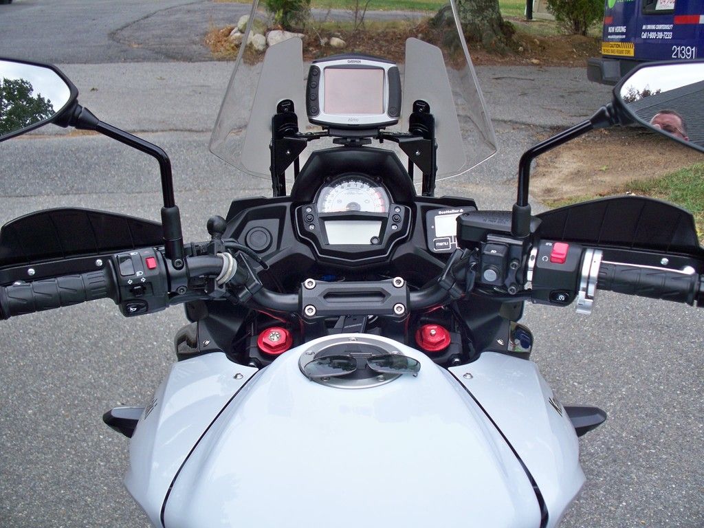

After much waiting for the parts to become available, I spent the morning installing 1) SWMotch GPS mount
[IMG][/IMG]

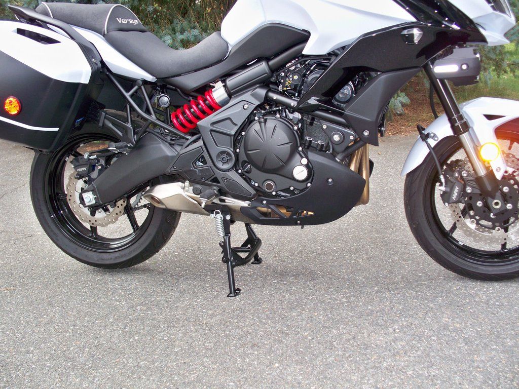

and 2) SWMotech center stand
[IMG][/IMG]
Both were fairly easy to install, the only thing I see right now, is the side stand and center stand touch when up. I will need to see if they can be adjusted a bit.

Yes, the bar ends are there...just outside of the picture.
Perhaps a small rubber pad between them? Nice job BTW the center stand is one thing I would have liked.

Can we get a shot with the center stand up, Would like to see what it looks like for clearance.

...Both were fairly easy to install, the only thing I see right now, is the side stand and center stand touch when up. I will need to see if they can be adjusted a bit.
get some pcv tubing slit it and line the inside with some thin double sided tape - stick it on the side stand or center stand tubing - put it where it will allow max height of the stand in up position and reducing the rattle.

Center stand up

1. Be sure you cut the plastic underneath cover (left side) with the template provided in centerstand instructions: Shears cut through it like butter.
2. YES, when your center stand is up, your side stand NEEDS to be out too: unless you want to fumble with it just to look cool. FOR SAFETY, you really need to mount it with the side-stand down anyway, so the side stand is ALWAYS down when you are not riding now
No problem really, its just a procedural thing. It's hard to fit a centerstand on at all on the Vs. 650. If it was easy, Kawasaki would have done it!
But it would be hard to live without a centerstand once you have one!
(Note: NOT for lowered Vs. 650's! Sorry.)
