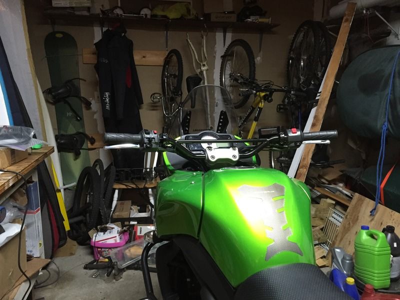

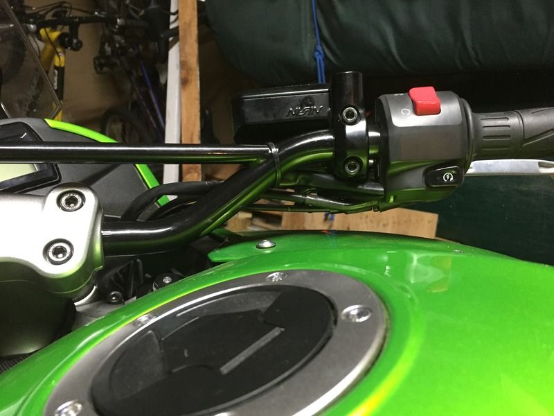

I impulse bought a cheap set of Moose Carbon Steel CR High Bend bars on my lunch break today. They are Lower than the Renthal RC High bend bars I had been looking at, and even running them upright as I generally prefer, it will be a close fit at best over the tank. I may have to get creative with the front brake line attachment as it looks to be the lowest point the way I have my perch set.
If these work, it will put my hands roughly an inch lower, 1-2 inches further forward, and with a better an angle that has less sweep. I figured for $25 it was worth a shot. Looked a tad odd riding home with them.

They fit, but not by much. I had to turn the 90 degree banjo fitting on the brake line counter clockwise just a bit to clear, but otherwise they fit lock to lock with no issues. Waiting on some regular style bar ends to come in, so for now I'll run them without weights and hopefully vibes won't be too bad

I love these bars on the Versys. They did exactly what I was hoping for. Still upright enough to be super comfy for me, but my wrists feel better and it's a huge difference for me in twisties. I can now use better body position through a turn without feeling really cramped like. It weights the front end a little as well, and gives what i consider a more planted front end feel. Also puts my arse at a more favorable angle for me; a slight change towards sport touring seating, but not nearly as extreme. Added benefit is being a touch wider, it puts the mirrors out a bit for less of a shoulder view. Seemed to steady the left one a tad, but I put on Tuono mirrors yesterday anyway, now i can see whats behind me clearly.
One downfall is running without bar weights they are extremely buzzy. After one day of that, I got the hardware needed to convert the OEM bar ends to fit, and now they are acceptable for me. I think still a touch buzzier than stock though, probably due to the crossbar stiffening things up. It's not removable on these lower end steel bars.
So, if you're like me with long torso and arms, and wide shoulders, and looking for a way to open up the rider triangle on the Versys to give it a slightly sportier feel, here's a cheap way to do it.
