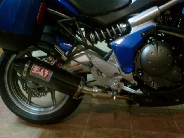

post #13 of 35 (permalink) Old 01-31-2013, 11:45 PM
Posts: 7,106
Yoshi Slip On with 6' extension.No pop up
