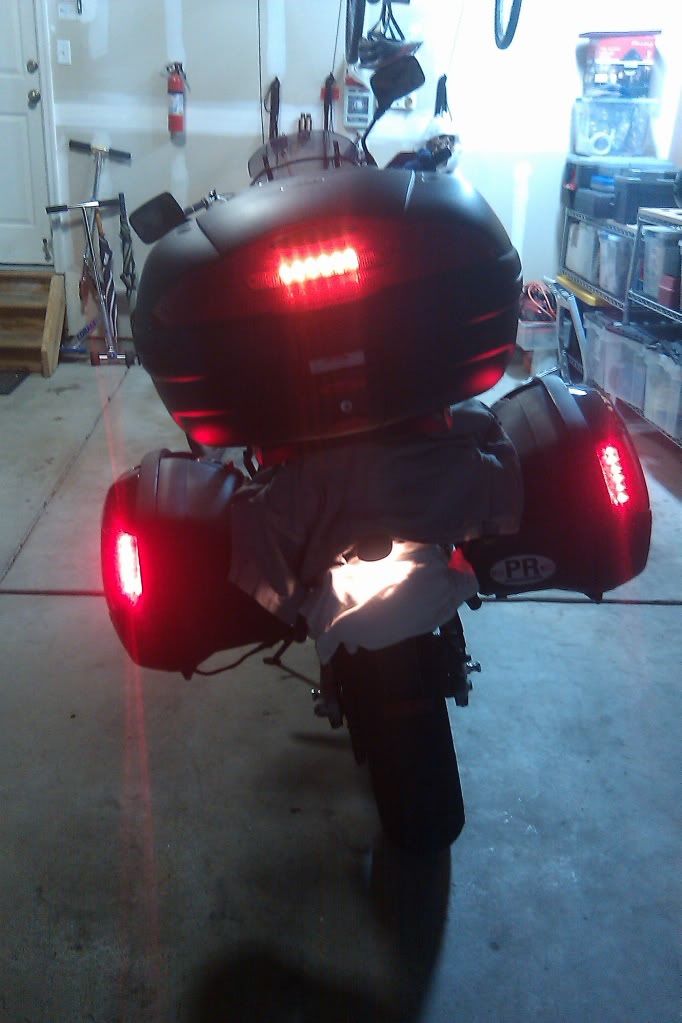

Home made light kit using led strips. Panniers have the signal lights wired separately.

Thats a very nice setup!
