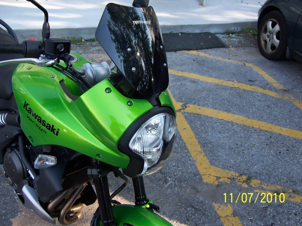

I'm 6'2" also and...like others have found flipping the windscreen upside down locating it in the highest position helped decrease wind buffeting.
I went a couple steps further by drilling 2 extra holes for a little extra height...and painted the inside with satin black paint.
Heres a pic...I've since de-badged it and lowered it a notch or 2...
