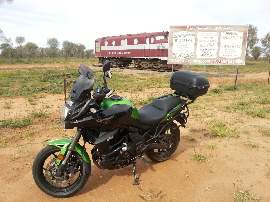

Mine are mounted at the front of the crash bars out of harms way
