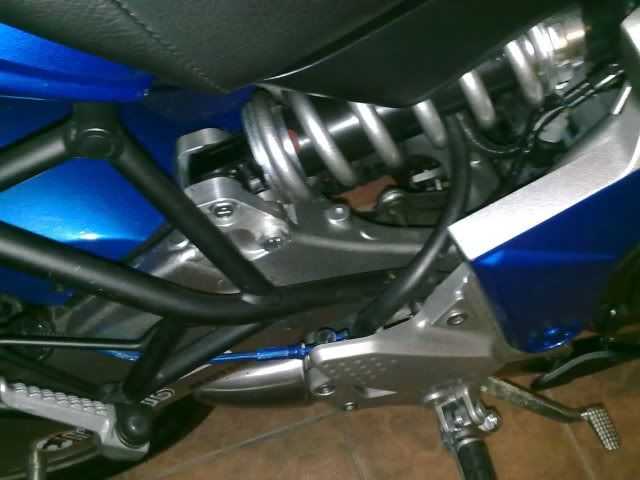

I need to know, on a '09, canadian or us model, the sequence for the hose that goes from the rear brake fluid reservoir to the rear master cylinder
I did the lowering footpeg block today, and I feel that something is off
From the outside in
The footpeg plate
The hose (from reservoir to master cylinder)
The subframe/frame
The brake light wire
Tha rear wheel
I'm not 100% sure for position of the hose
I tried to pass the hose behind the reaar subframe, but it's to thick and doesn't pass in between the rear subframe and the front frame/engine (it could pass, but I would have to sweeze the light out of it)
On the other hand, the hose looks very close to the spring of the rear shock assembly
Can someone clear the fog for me
Thank's all

Visual aid..

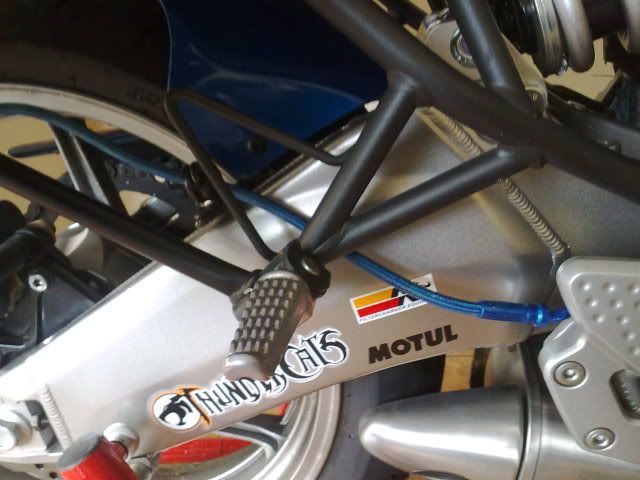

Here are some images on the brake hose; Hope it helps.

+1 on that picture, seem like I put it back correctly

Thank's for the piscture, but it was the hose from the reservoir to the master cylinder that was a problem
The line from the master cylinder to the caliper cannot be displaced
Thank's also for the trouble

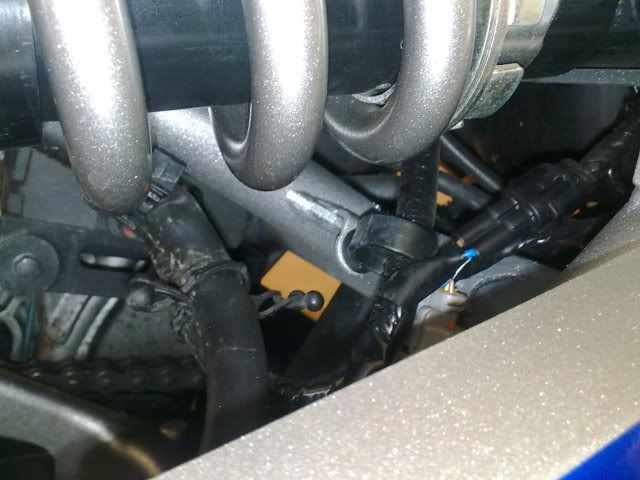

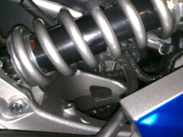

sorry If I got you wrong there, anyway did check and found the hose a little close to the spring and did a cable tie around some wire to get the distance. Some images for your reference, Hope not wrong this time.

Those new pictures also depict my "concern", since in the morotwerk instruction, I couldn't see the feed line from the reservoir to the m. cylinder
I also think that maybe the picture in the motowerk instruction are from a previous year and maybe Kawi did change something

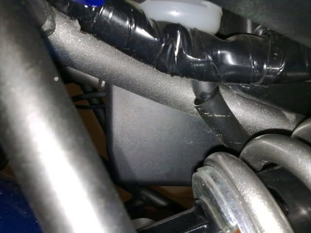

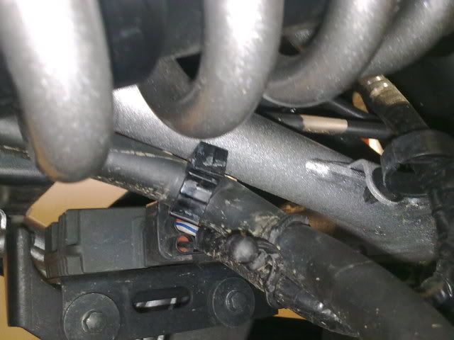

Came home from work thinking on the brake hose been too near the spring. Took a close look and saw the hose was out of its lock. There is a Clip Lock to keep the brake hose away from the spring. Take a close at yours, might have come off.Here are some pictures with the hose in secured Lock position.
The hose in Lock position. The Lock clip is attched to the subframe.
