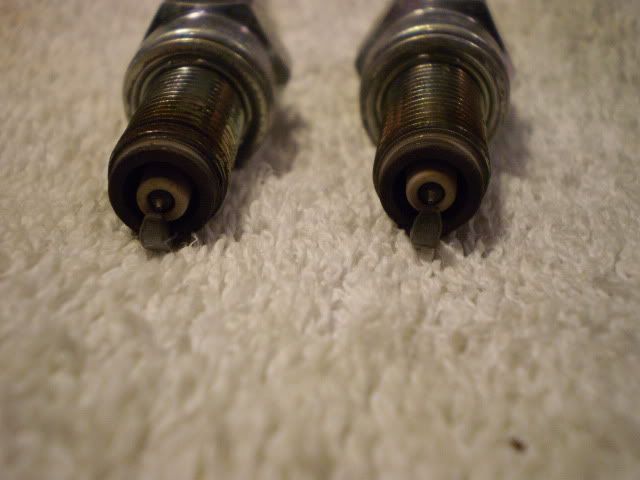

Denso IU27, or IU27D (with removeable nut on threaded connector) with 0.4 mm diameter iridium center electrode are the replacement spark plugs listed for NGK's CR9EIA-9 with 0.7 mm diameter iridium center electrode. They are both excellent plugs, and the best available... The recommended 12000 km (7500 miles) spark plug change may seem short, but they still do wear down mostly at the ground electrode, which increases the gap. Square edges also round off, increasing its arc (spark) resistance.

Only the center electrode is made of iridium alloy... NGK and Denso spark plugs are manufactured with special shell plating on the metal body. Anti-seize compound may cause over-torquing and is not recommended. The M10x1 (10 mm) thread plugs should be torqued to 11 ft-lbs.
