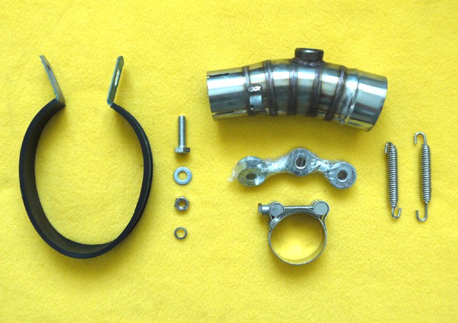

I got a new exhaust off ebay (generic) just to try something out. The mid pipe that came with it has 2 challenges:
1- It has an oxygen sensor bung and my 2011 does NOT have an oxygen sensor so I will need to plug it. Noth that much of a big deal as I found an oil drain plug that fits perfectly.
2- The BIG ONE the diameter of the mid pipe where it attaches to the headpipe is the exact same size as the headpipe! So there is no way it will fit properly!! What should I do? And PLEASE don't tell me to buy a better exhaust
Also to make matters worse the spacer/gasket thingy tore up when I removed my stock brick exhaust....

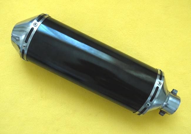

No it is not the same diameter and the other side fits in the slip-on and is heald on with springs so there is no way I can install it backwards. As stated, it is a generic brand pipe...I guess I got what I paid for
This is it: (Don't laugh too hard
This is the mounting kit....

You should be able to take the pipe to a muffler shop and have it expanded to fit over your mid pipe.
You can buy exhaust expander tools pretty cheap at the local auto parts store and do it yourself as well.

I've seen that pipe before. It's made by Cracker Jack and comes with a prize.

Holy cow! You got it for free! That is one nice system though. Just have a muffler shop expand it just enough to fit over itself, if it's the exact same outer diameter as the header collector outlet. Just make sure it'll be long enough for when it's slipped in and assembled.

I just went to O'Reillys and borrowed an expander........SUCCESS! I'll take some pics and report back when she is running.
