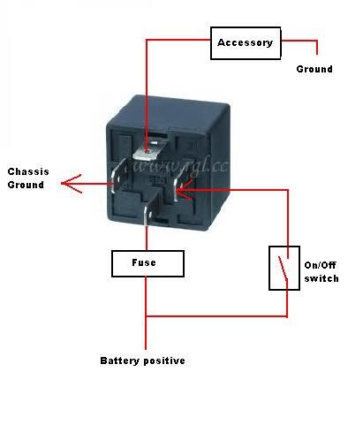

How to build a relay controlled circuit
A relay is basically an electrically operated switch. Buy a generic 4 pin automotive relay. They're cheap and available at most auto parts stores. The switch circuit is very low power, while the switched circuit can handle high current flow. Energize the coil side of the relay from a source that is only on when the engine is running. For example pin 85 to Ground and pin 86 to the tail running light. Power the relay from the POS terminal of the battery (pin 30) via a fuse in an installed inline fuse holder of suitable capacity. You now have a high current power source, that is only energized when the ignition is ON, from pin 87. Optionally you can connect pin 87 to a wiring block to provide more than one connection point if you have multiple accessories.
Note some automotive relays will have five pins with the additional pin labeled 87a. The extra pin functions the same as pin 87 with the exception that it supplies power when the relay is not energized and switches off when the relay is energized, the opposite of pin 87. If you use a relay of this type remember to insulate the unused pin so it does not short out on the frame.

Only one relay is needed for all your accessories but I would connect a fuse between pin 87 and each accessory. Most accessories like heated grips come with in line fuses anyway. Optionally you can buy a cheap terminal block to provide extra connection points to pin 87 of the relay or just connect the wires together at pin 87. Suggest 12guage wire.

So how would you turn off the driving lights? What would stop a high powered horn (like a Stebel or Bad Boy) from blowing? IDK if it's just late and I'm not thinking right.

You need a separate switch and relay for different devices otherwise in your case your spotlights would be on whenever your heated grips were on.

can't you put a switch inline w/ the lights after the relay???

This is what i understood, in graphical form. Correct me if i'm wrong.

That's the question I have. The problem I see is that then you'd have a high current device being powered by a low current switch, which is what you are trying to avoid by putting the relay in, in the first place. ????

For some accessories that would draw quite an amount of current such as hid spotlight or grip heaters. I cant be sure if the stock wire loom could handle the load, hence for peace of mind, pulling a connection with wire that can surely handle the load is sensible.
I shall leave the stock power ports for low-draw items such as charging port and running led lights.

One thing with multiple take offs from a single relay is to make sure the relay is up to the task. Mini relays may range from 10 amps upwards.
Calculate your total current draw and make sure your relay can handle the situation, otherwise a great simple system.

I noted from ebay there are relays that has built in 30-40 amps fuse.
**important** i found out that fuses should be placed BEFORE the relay.
So are you saying that if we are to use a mini relay, then we shoud be wiring multiple relays, one for each accessories that we are going to use, right? But how about the power that is used to activate the relay? Can we tap from a single source for 4-5 relays? What about if we run a direct 12V power from battery as the activation power and ground it back to chassis? The switch will both activate the relay and at the same time activates the accessory.
But that kinda defeats the purpose of having relay, no? Why not we just wire it direct? The switch will ensure the circuit is broken and hence no power running. So what is the purpose of having relay anyway?

The ideal situation is to have multiple relays with the battery feed looped to each terminal 30. You then switch each relay terminal 85. The switch required to activate the relay is a small low current switch. Also the wiring can be much lighter. You can fit a fuse or circuit breaker between the battery and the first relay. If you are running lights a circuit breaker is good as it just interrupts the lighting circuit, switching on and off. It has a bi metal strip on one of the contacts. This way you still have enough lighting untill you can stop.
The reason why relays are run in vehicles is to reduce the wiring size = weight and cost, to run lighter switch gear and to reduce the amount of wiring. Running heavier loads through modern circuits ie fitting higher wattage bulbs in headlights, 1, you will get a voltage drop at the light ( the wire is to light to handle the current) and 2, your switch gear may fail. The switch contacts are not heavy enough to handle higher current. The arcing will destroy the switch contact. The ideal world is to run one relay per circuit with that relay being switched.

Youre missing the point. Only a single relay is needed. This sits next to the battery to supply a high current ,.switched source. If you have mult accessories you connect them to.a wiring block, each with their own fuse, that is energized by power from the relay. Using mult relays unneccesarly adds to cost, weight, and complexity.
