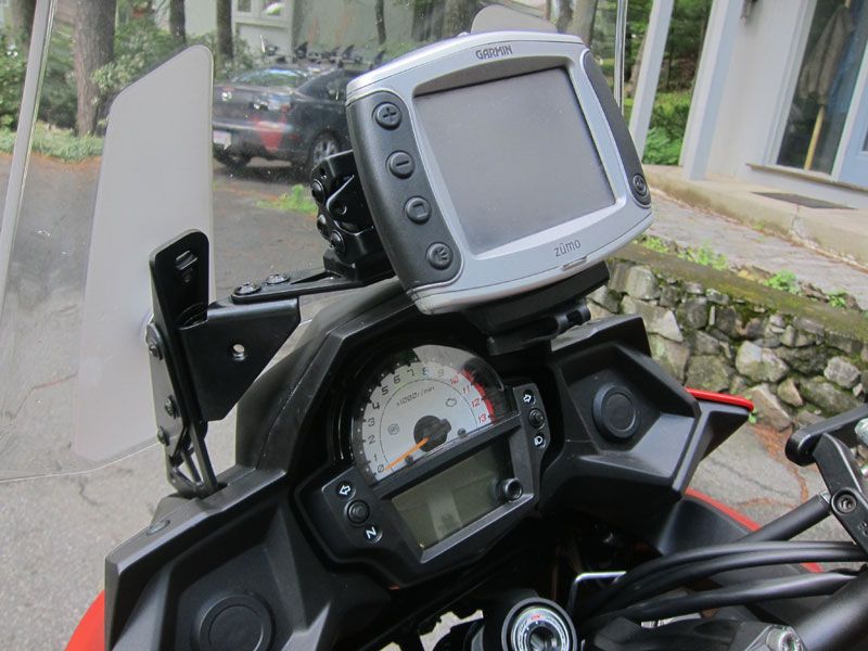

One item I would not recommend is the SW Motech over the clocks gps mount, if you have a Gen 3.
I like the idea of it but my Zumo 550 bounces up and down a lot, especially in city riding. Also, the angle is too steep and I get a lot of reflection from the sun. If I rotate the angle down any further the gps blocks my tach. Both issues might be better with a Nuvi as it's a slimmer case and most likely lighter in weight. Mine is hard-wired into the bike so I'm going to leave it but I'm mostly disappointed.

I love mine, No vibe issues and I can see it fine. Mine is a Zumo 660, maybe that makes a difference. It's easy to reach and I like how I don't have to look down to see it. The whole thing is for sale though since I'm selling my bike.
To be fair it doesn't bounce around when I'm riding on the hwy, the problem isn't bad unless I'm around town and that's when I need the gps the most. I don't blame the mount as much as I blame the fueling of the bike. My Versys stutters so much at low revs that it shakes the mount, mostly during acceleration or roll-on at city speeds.
