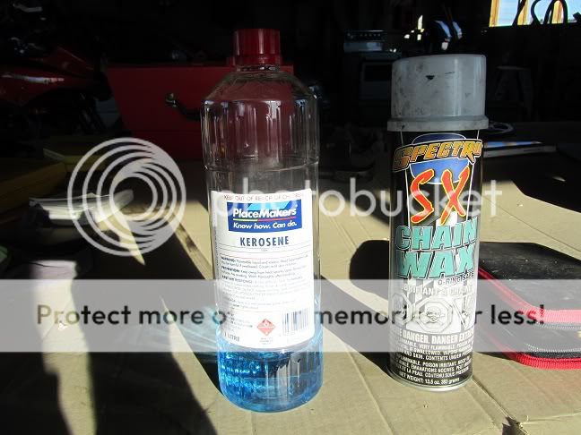

Agree with Phil, chain failure is the culprit in the extraordinary wear on the sprocket. What kind of lube and frequency of lube?

Cleaned with kero and used this chain wax but was pretty slack in early days as when i went for a 2600km ride a couple of years ago the chain did not get done to we returned home. Try to have chain waxed before every big day ride now or at least no more than the 600km recomendation
