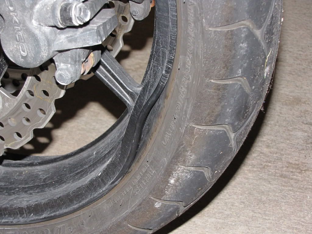

Sadly, riding home in the rain tonight, just past dark, cresting a hill and saw something in my path. Only had time to brace for impact - and hope it was a soft item. Looked like an empty paper lunch bag. Nope. It was a rock or slab of cement maybe, just laying in the road. Pretty solid impact on the front tire, had a little wheelie action but managed to keep upright. Was going about 50 km/hr.
Only a few blocks from home, I carried on and then saw the damage. This is the left side. The right side has a slight bend, hardly visible, but you can feel the wobble if you run your hand along the bead.
So, my first thought is REPLACEMENT. Any one have thoughts or experience with REPAIR to this sort of damage?

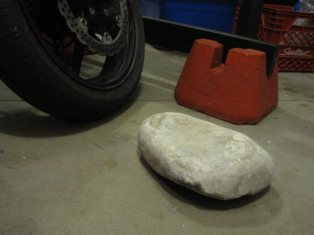

I went back today and found the evil rock that caused the damage. Big, heavy, flat, didn't give way much when I hit it as evidenced by my bent rim. Really glad I didn't dump it.

Damn, that's a big boulder. Have you phone around MC shops to ask if they know somebody?
