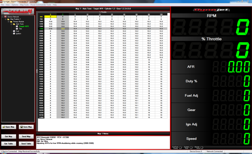

attached is my AFR table
Note that putting anything in the zero throttle column is not recommended by PC.... but i read on some race and snowmobile forums that if you are popping on deceleration it is due to overfueling, and you can put in leaner values (higher AFR #) in the lower rpms to reduce the fuel and eliminate the pops... It works for me and my Leo Vince under body exhaust and i run without the db killer baffle.
EDIT: removed the attached pic see below

sorry about pic... stupid attach file reduces the pics to a thumbnail... only to display a thumbnail!
here is my AFR table

Soooo.. now we have established that ZERO PCV+AT200 you run better.
because it runs better with PCV off... then the problem is before the O2 sensor = headers.
I would seriously look at the header pipes. pull them off, test, put back on with new gaskets and studs/nuts. OR just upgrade to an arrows header
ANY air entering the pipes will cause issues like popping.
Once you turn on the PCV+AT200 with real tables... it is overfighting the fueling as it is sensing the extra oxygen in the header and adjusting the fuel... basically a really bad close loop situation. PCV and AT will be fighting all the time throwing the trim all over the place. and because air entering is not constant, the results are mixed and confusing.
