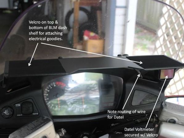

Wish he sold a dash shelf, I could sure use one.
Here are pictures of a dash shelf that I used on one of my bikes in the past. they really come in handy. The place where his GPS mount fixes to the windshield bracket would be perfect:
