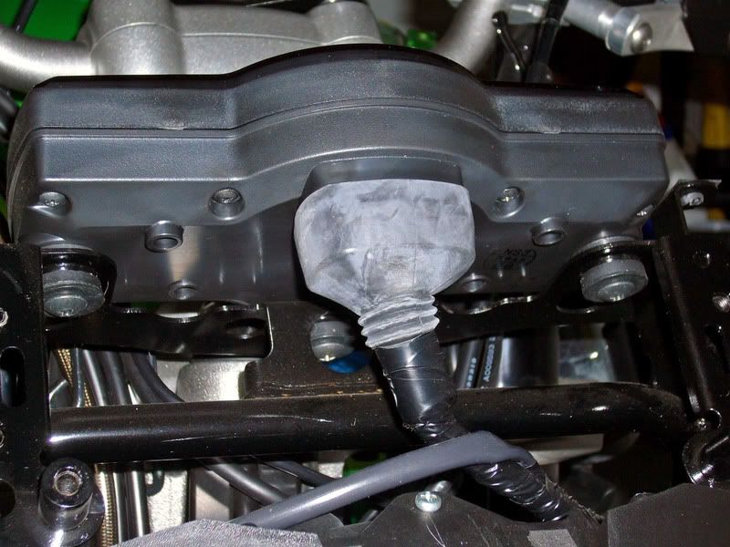

So, the cowlings came off again. I started rapping lightly on the metal cowling/gauge frame with a rubber mallet. I could hear the instrument gauge unit buzzing lightly each time I did this. However, touching the gauges while rapping did not reduce the buzz.
This is an "AH-HA! I GOT YOU NOW, YOU LITTLE BASTARD!!" moment.
The buzz is coming from INSIDE the instrument gauge unit.

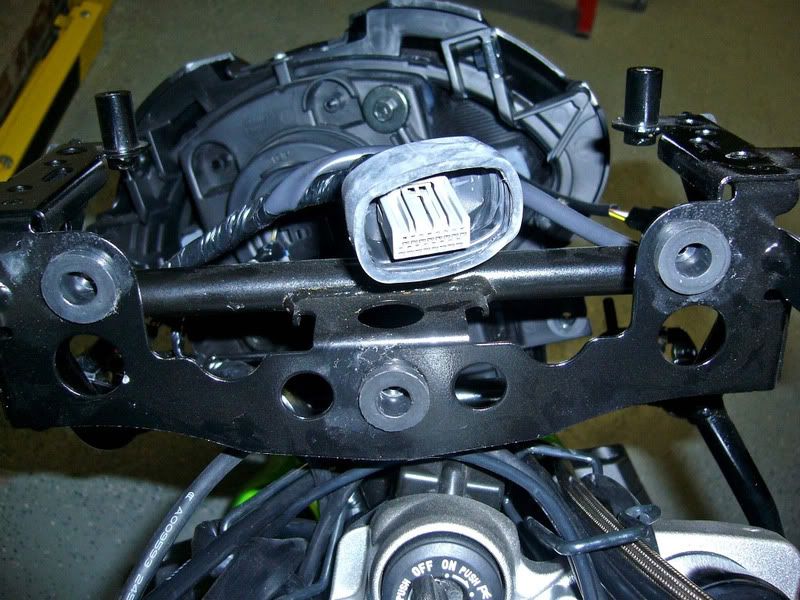

So, I removed the headlight to access removal of the gauge housing.
Then I removed the 9 screws on the back side of the gauge housing. Don't be afraid to do this. It is very easy and nothing falls apart or is difficult to put back together. No seals are broken either, so no worries.

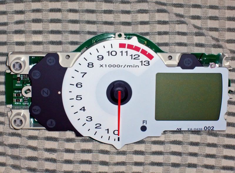

I found 2 possible buzz sources inside the housing.
The first source is less likely, but I fixed it anyway; the white face of the gauges "floats" on top of the inner gauge body without really being very secure, even when it is sandwiched between the top and bottom of the gauge cases, so it still has a slight gap around most of its outer edge. I fixed this potential buzz source by minimally tack welding the white gauge-face edges to the inner gauge body using superglue. Easy, and I can easily use a razor to break the bond if I need to replace bulbs later.

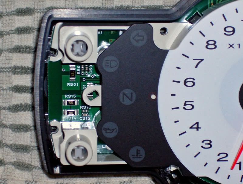

The second possible buzz source was definitely causing most, if not all of the gauge buzzing. Looking at the picture below, you will see the two housings for the "Mode" and "Reset" micro-switches. The little "X"-looking pieces inside the round tube of the switch housing have too much free-play inside the round tubes. When the bike engine revs, the "X" pieces rattle against the inside of the round switch tubes.
So, I found the main buzz problem, but how did I fix it without affecting the performance of the two switches? That is the question.
The answer; with 2 small pieces of 1/4" heat-shrink tubing, slid between the "X" portion of the switch and the inner wall of the round switch housing. Looking at the picture below, you will see the top switch has the shrink tubing already installed, and the lower switch still needs to have the shrink tubing slid down into place. The shrink tubing must be cut short enough to allow the switches to function. If the shrink tubing is too tall it will limit switch function. Once the tubing was in place I heated it a little to keep it there. There is still enough play in the switch, but the "X" no longer rattles in the round switch housing.

well not so fast. i took my gauges off today and installed the shrink tube. but when i would shake them the rattle was coming from behind the small screen. i held everything tight but it still had a rattle inside. i don't see anyway of getting behind the screen without removing the circuit board. any idea's before i put it back together ?

What small screen are you referring to, the LCD? I'm not sure what that rattle would be. Perhaps the white gauge face is creating the rattle. Is it secured with superglue or silicone?

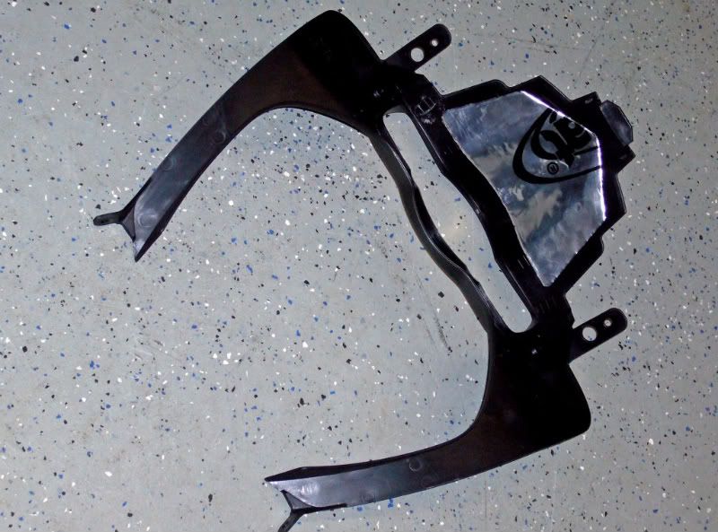

I have posted this before, no feedback from anyone, but a simple fix for mine was ultimately after lots of foam taping, a small nylon spacer wedged under the front surround headlight. That is where the howling comes from.

Where, specifically, is "under"?
I see a black plastic piece that surrounds the headlight. On the bottom, that piece snaps into another black plastic piece. Two tiny tabs hold it in place. Not sure where your spacer is going. Thanks.

yes the lcd screen. my rattle is inside.
I'll take a pic tomorrow and post it. Basically it is wedged between the black cowl and the headlight surround. It was so simple that I couldn't explain it. Try holding down on the black cowl around the headlight and if that quiets the buzz, then wedge something between the two pieces. Foam tape didn't help, but the wedge did the trick.
Element,
Is this the area you are referring to?
If this is what you are referring to, your specific fix is actually pretty commonly done and talked about by Versys owners experiencing the buzzing. I also tried that fix, but it did not quiet the noise.
The parallel twin of the Versys seems to create a vibration/noise problem for many Versys owners. Your fix works some of the time for some of us.
I posted my fix because I had not yet heard of it, and because it actually worked for me. If it doesn't work for others, then there is probably another source of vibration that will also need addressing.
That's exactly where my buzz was coming from until I fixed it by using a couple small pieces of thick high density foam tape between the headlight and the tab on the black cowl.
I did the same thing Enigma did with zilch for results... What I found was the rattle was coming from the reostat that controls the tach...Short of desoldering the whole friggin board and having my wallet emptied by a few hundred I just buttoned it up and bought some ear plugs

I used Enigma's cure for the dash buttons except I used a drinking straw instead........this is a sure-fire fix for the gauge buzzing, thanks Enigma for the solution!!
I'm glad it worked.
I like your straw idea better than the shrink tube method. The straw would probably be less likely to cause issue with button function due to its smoother and more rigid surface.
