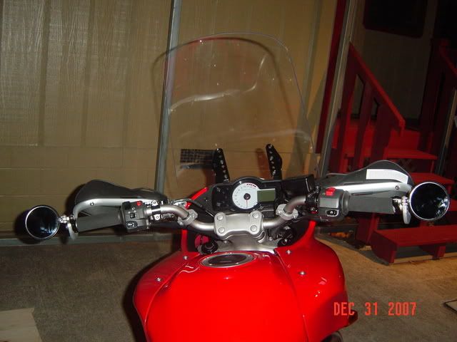

CRG W/ACERBIS HANDGUARDS

anyman & golfmuch it's hard to tell exactly from the pics but how did you mount your mirrors? golfmuch - It's hard to tell if you have them mounted to the handlebar or the right over the barend. antman - your's look like you have them between the barend and the end of the handlebar.....

Thats exactly right. I had to cut the grip about an eighth of an inch. I just cut it at the final grip line on both sides. The throttle also had to be cut about an eighth. Because the bars arent hollow at the ends, they are welded and threaded for the bar end weights, I opted to use the clamp around the bar option. Plus I wanted to keep the bar end weights installed to help with the vibes.
I guess you could cut off the ends of the bars and install them using the bar end option which is designed for use with hollow end bars, but I'm not sure how the vibes would be since you would not be able to use your bar end weights.
