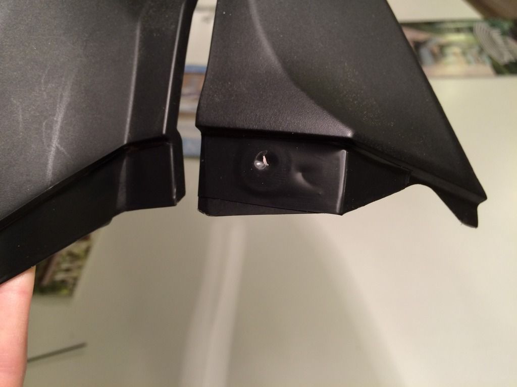

I have had the plastics off about a dozen times. I replaced my girlfriend with the versys, and I like getting her naked. Remember to lube the grommets. Read the manual carefully the first time. There is a flat hook that holds the middle fairings at the top that seems very easy to break. Hold this junction together with one hand, pull out the 3 rear grommets, lift the top part of the fairing off the tank attachment point, and lower rear of fairing to release the hook. You may also have to push the fairing in to lock this hook when re-installing.

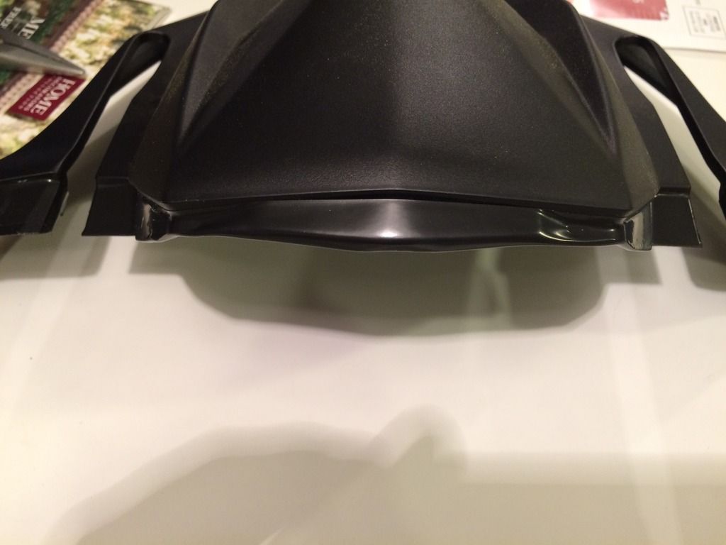

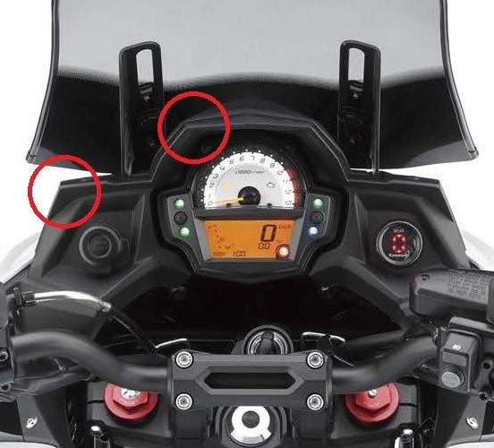

I found another source of buzz around the dash panel. I did not know if it was my imagination, but I thought I could hear a subtle buzz at 5000 rpm while engine braking. Now that I have fixed it, I know it was there.
Buzzing areas circled in red
Remove the meter cover and apply electrical tape to the tabs that connect with the dash panel.
Punch holes for the rivet pins.

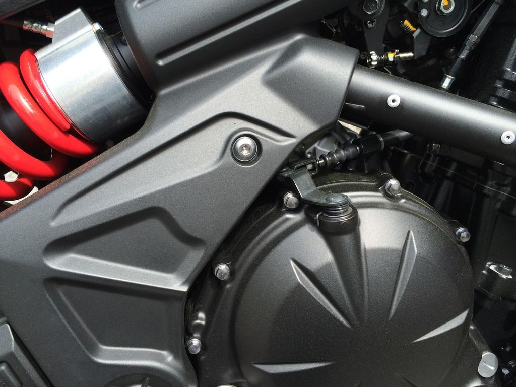

I also found that this side panel was loose. The spacer for the bolt is a little too long. I added a washer to hold the panel firmly. onewizard reported the same thing. My left panel was loose, I think it was his right.

Yes, how I found it wasn't from a rattle but from the fact I thought I was going to round out the allen socket of the bolt, when put back it was then I came to the conclusion it was over tightened because of the spacer. Need to explain that, there is a insert/ oversize washer that fits inside the plastic, the spacer from the frame to this one is too long, resulting in the plastic being loose, I added a rubber washer to the "insert/oversize washer", end of problem.

The panels are literally designed to buzz. You have two plastic surfaces in light contact with each other secured by two push pin rivets. The only dampening pad is used at the top. Of course it's going to buzz. In truth, I had to ride without a helmet to really hear it over the engine noise, but the bike sounds so much smoother without the vibrations. I have removed the cover more than several times, and this probably made it worse. Easy fix, though.
