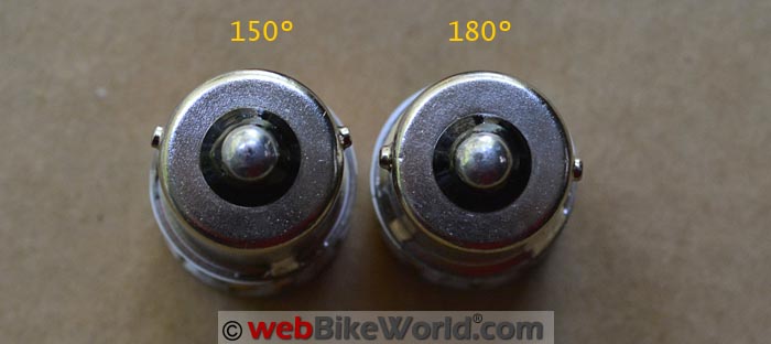

NO. Our bikes need RY10W NOT the R10W
I tried ALL the parts stores with no luck. While they had some of the R10 style bulbs that you are stating above, they DO NOT FIT. Forget about finding an amber set! The guide posts are not oriented right to fit in the sockets of the Versys turn signals. After doing some extensive research the posts on the Versys bulbs are at 150 degrees offset, where as all of the standard automotive bulbs are at 180 degrees (directly across from each other. Like this:
So What I did temporarily was buy a pair of #5008 10 Watt bulbs, grind down one of the posts flush, paint the clear bulb with RED nail polish and install them until the correct replacement bulbs I ordered come in. Was a bit of a PITA but they will work. I kind of like the red rear signals better than amber too.
