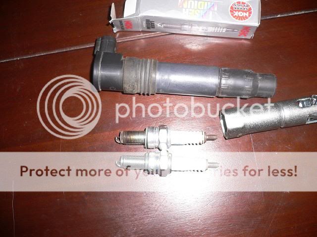

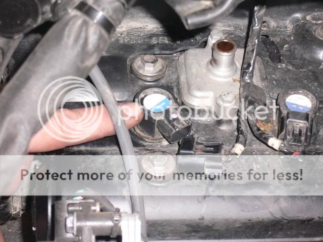

Finnaly decided to change plugs but a bit stuck removing connector off plug as in photo, does it just pull staight up or do you need to hold your tongue a certain way?
post #2 of 17 (permalink) Old 08-03-2010, 03:10 AM
Posts: 7,129
Its call a stick coils so you have to remove that first, just give a slight pull as the plug as a copper head with a grove, so just be careful and pull straight up.
post #3 of 17 (permalink) Old 08-03-2010, 03:26 AM
Posts: 7,129
16-42 Electrical system -Kawasaki Manual.
Just give a slight pull and you should free the coil from the plug.Don,t use any screw driver as you might damage the coil.

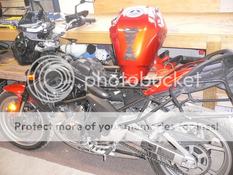

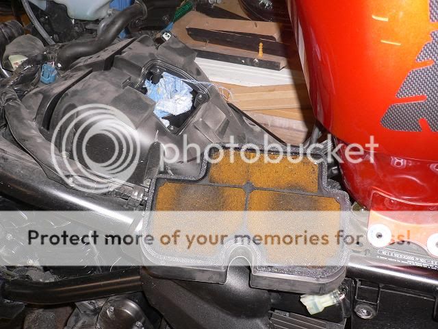

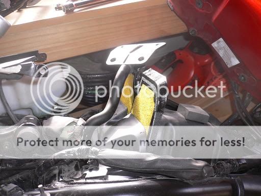

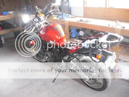

Thank's for that fastO, removed the stick coil and then got the plug out using the plug spanner that came with the tool kit, with a socket (14mm)and my ratchet on it, did not need the extensions. Was going to get a retired mech help me with plug change so I know what to do next time but went for my warrent of fitness and guy at garage said my headlights to low and off to left so thought I would take all the covers off adjust headlight and keep going and see how hard to move tank (no probs) took air cleaner box off but forgot to undo rubber hose under box to rear but no harm done it just popped off. cleaned air cleaner and got stuck trying to remove the stick coils but thanks fastO they pull straight up. Its dark an cold now so bike staying in garage with one old plug in until tommorow the re assembly.
Just used my work bench and keep fuel line connected and stood tank up, was sitting very secure without tying up (hope we don't have earthquake overnight)

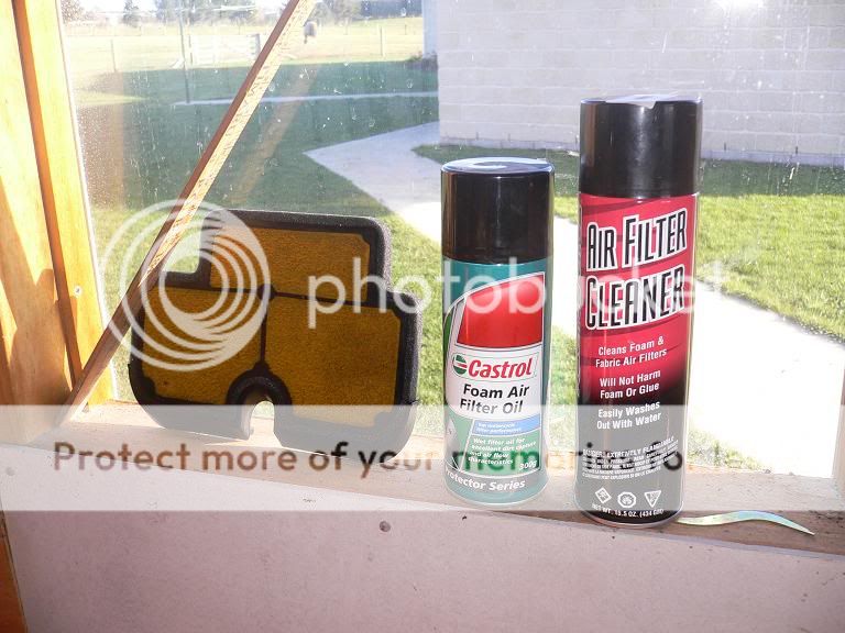

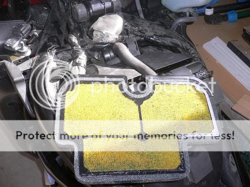

Gave the aircleaner a good wash and it is drying out overnight and will re oil
The new NGK and the old

That Air Filter also needs replacement IMHO.

Is that not a washable foam filter?
Yes, it's washable. I use NoToil "oil" which is biodegradable, so you can wash it in the sink the next time it's due.

Have washed the filter with cleaner then flushed with my hose then washed in tub in warm soapy water then rinsed and its drying out and will spray oil in then replace should be all good.

Filter all cleaned
filter going back in

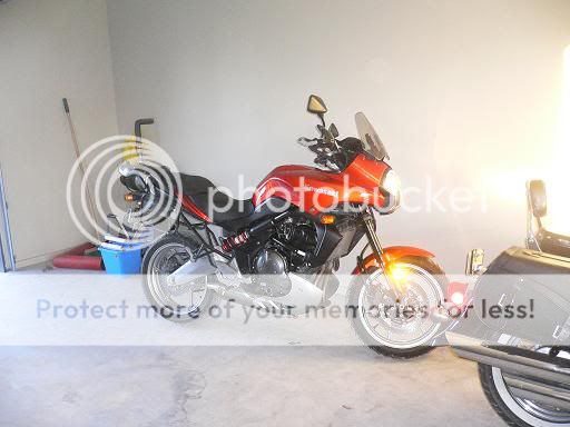

tank back on and had to do a test start and it went, yipee
After the required road test that you alway do as a excuse to ride and then she is put away to rest to the weekend.
