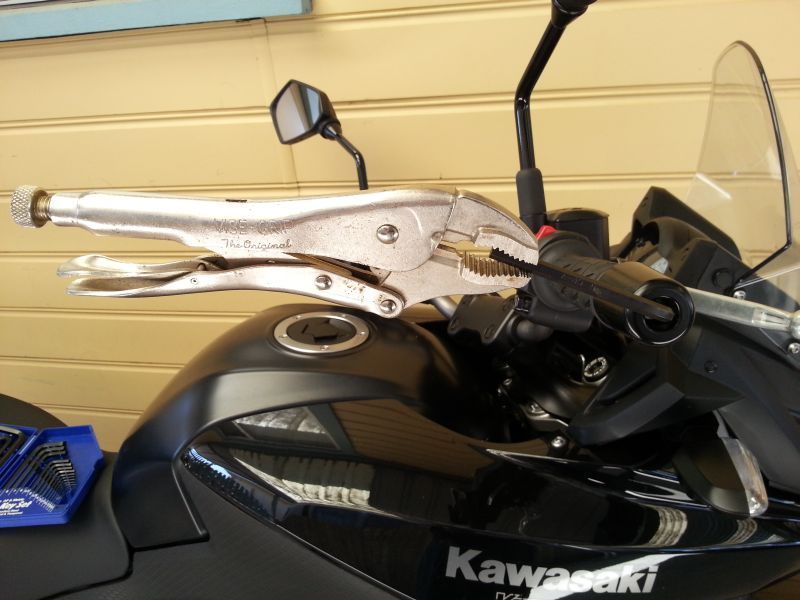

The only difficult part is removing the OEM weights at the end of the bars. The threadlock they use is tough to break. Use good quality tools and you will need a bit of weight to move it. I used vise grips and a rubber hammer.
Good luck with the new bike and don't forget we require photos
