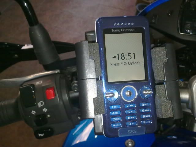

A cheap solution to mounting your camera/GPS/phone on your handle bar.

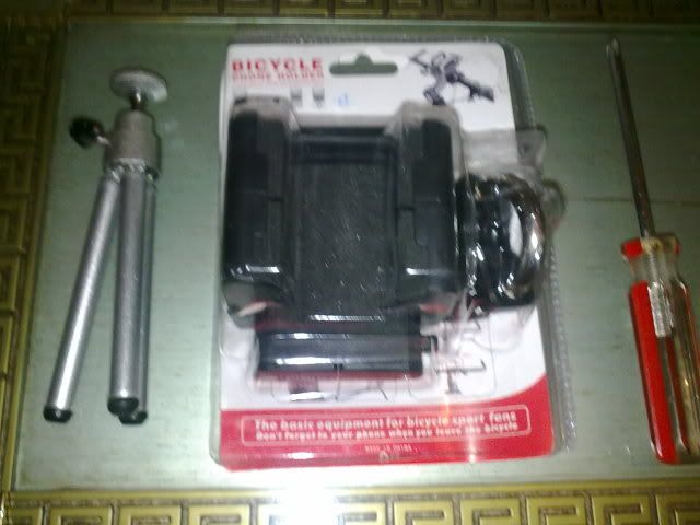

one unit camera tripod/one unit cycle phone holder/tools
The phone mount and can also mount GPS-4'wide opening
The phone on the handle bar mount.

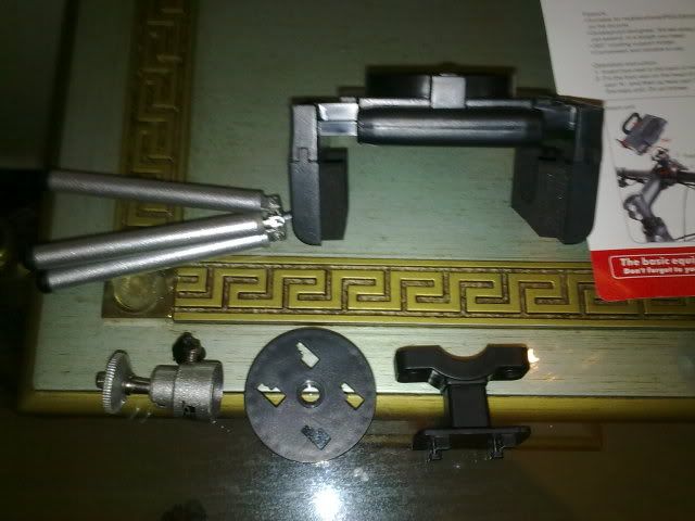

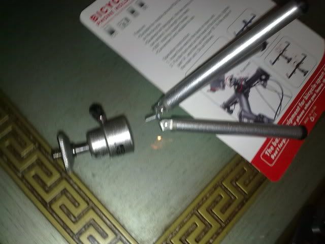

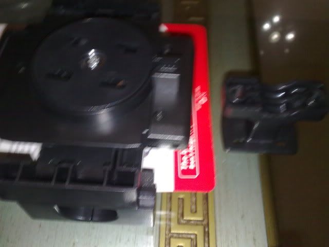

To convert to camera holder, dismantle tripod unit and use the top mounting unit only.

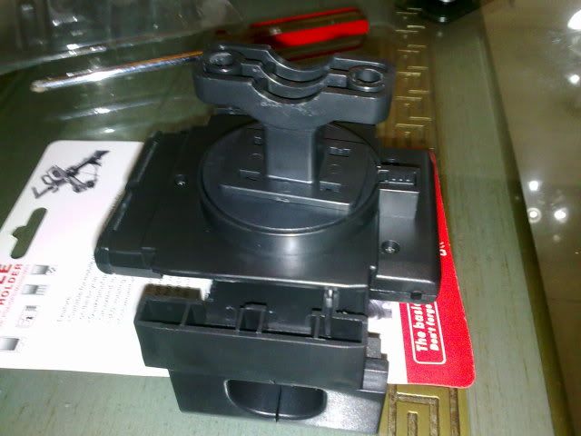

Next remove the bottom mounting unit with the clamp unit from the phone holder.
dismantled parts.

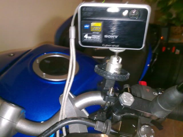

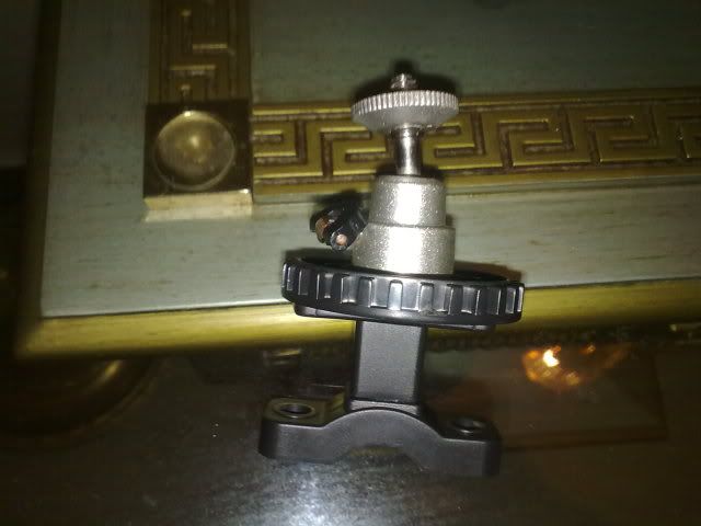

Fit the camera mount to the phone mount. use the screw form the camera mount unit.
final. camera mount.
You can mount GPS 4" max using the phone holder with any problem.
Cost: Phone holder USD 6.00
Camera Tripod USD 10.00
That is all the cost and you dont need anything apart from the 2 units and all of the required items are all in there. You just need to switch and work around to your needs.
Hope it helps someone looking for cheap handle bar mounts.

I tested my camera on the handlebar today.
The movie shaked because the ball pen mounting was not holding good.
Will try the cheap fix first (loctite). If this does not work, will try a fixed camera mount. Will post after further testing.
