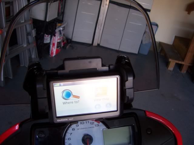

OK, just got my Universal GPS/MP3 holder mounted to my Motowerks mount. Was so easy, I was done in 15 minutes. Next I am ordering the electrical plug to get off battery power. This mount would work with any GPS, because it adapts really wide. Very pleased with the setup. Here is my pic, sorry it doesn't show the hidden Motowerks mounting plate. I just had to drill 2 holes to mount the holder, again-easy. I thought it would be a process but it wasn't. I hope the charging plug is as easy, but we'll see.
