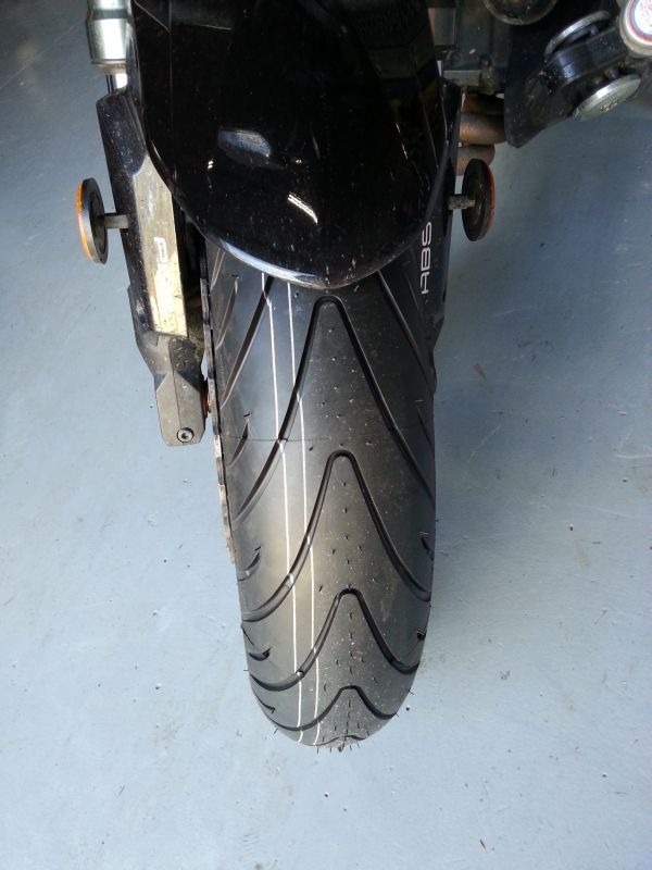

I noticed the other day that the tread pattern on the front looks backward from what you would think would channel water outward. The rear tire is opposite. After looking online, this seems to be the norm. There must be some physics going on here that I can't wrap my head around.
OEM Rear
OEM Front

original stock tires?
pr2
This is the stocker

Maybe the tread pattern on the front has something to do with braking in the wet?
