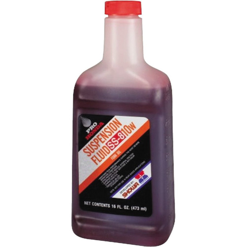

Service manual recommends Showa SS-8 (10W) fluid which is red, just like Honda's Showa SS-8 fluid. (Kawasaki and Showa have metal containers.)
upload img
Fastoman likes this.

I use ATF - red colored - in my forks, and have in EVERY bike I've owned since I started that when I raced 'enduros' back in the mid-'70s....
