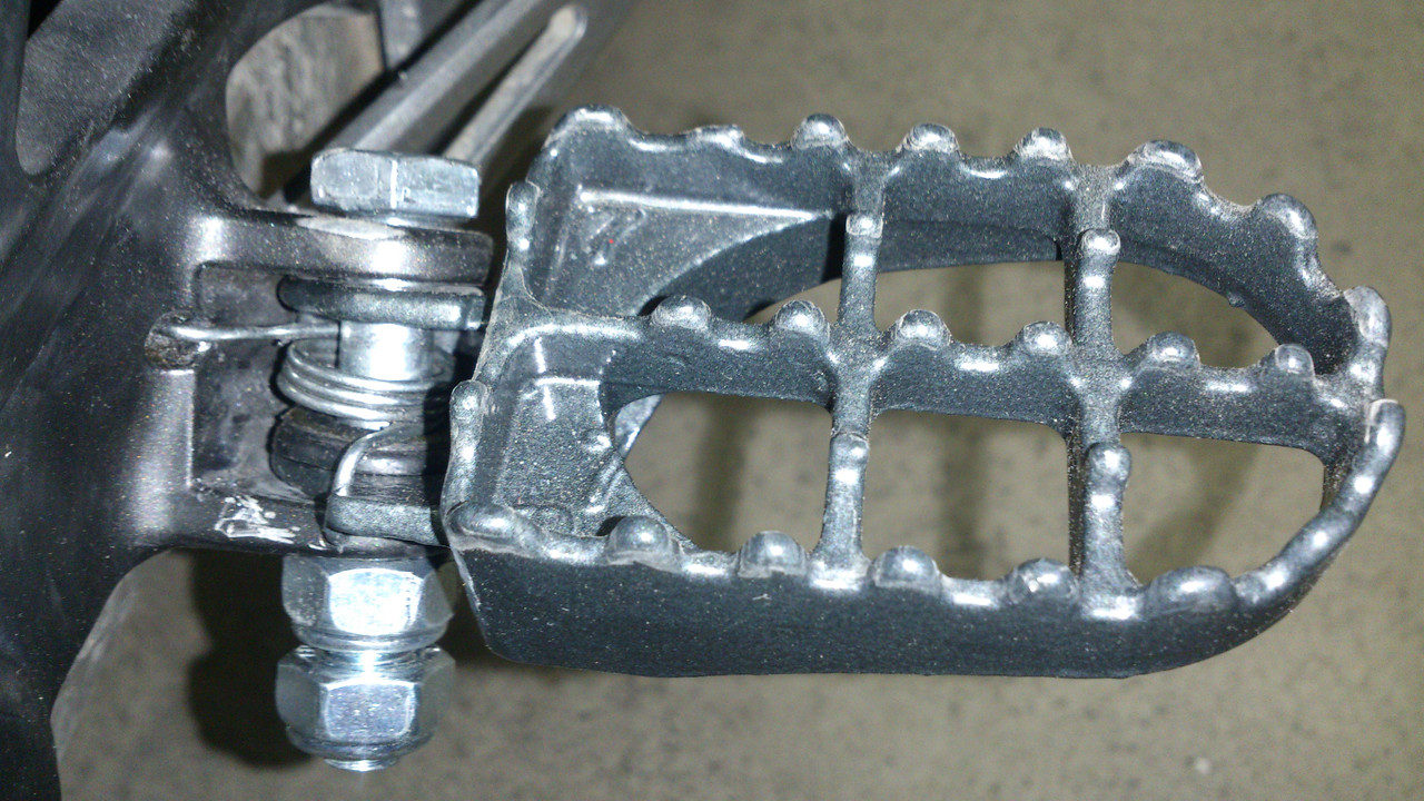

you said hill climb, so I think wide offroad / cleated pegs.
got the 20$ DR650 pegs suggestion from this forum.
with a bolt and nylock. You might enlarge the hole if you can, but that is to difficult for me (drill bit could jam) and the peg could be weakened.

post #11 of 16 (permalink) Old 06-24-2019, 12:21 PM
Posts: 17,699
Mentioned: 28 Post(s)
with a 8mm bolt and nylock. You might enlarge the hole to the 10mm if you can, but that is to difficult for me (drill bit could jam from 8 to 10mm) and the peg could be weakened....
I run the DR650 pegs on both my V650s, using regular 3/8" bolts rather than drilling anything. They work GREAT [and over MANY miles!]. Here compared w/ stock AND w/ 3/8" bolt/locknut combo on my Gen 1 ('09).
And here in yellow on my Gen 3 ('15):
Beezerboy likes this.

post #13 of 16 (permalink) Old 06-29-2019, 05:02 PM Thread Starter
Beezerboy's Avatar
Location: Alaska
Posts: 266
welp.... they don't fit. 75% miss-match on the holes. as I look back at the pix I see that you did is single shear loaded... not what I had in mind. I also have a lowering kit, so after thinking about, I'm going to mill the peg dropper out to 1/2". on the mill I can move the hole about .020 inboard so as to not lose any metal on the weak side. as for the peg, same, drill to accept tubing. I have 1/2" cro-mo aircraft tube with .058 wall. the I.D. fit is perfect to a 3/8" bolt. I'll probably braze the tube to the peg & it will be a snug slide in fit to the dropper

post #15 of 16 (permalink) Old 06-30-2019, 04:29 PM
Join Date: Jan 2016
Location: Montreal
Posts: 501
You're WAY beyond MY capabilities - the BEST I could do was just use the SAE bolt/nut, and it's worked for MANY years for me, tho' as you mention - perhaps it's NOT ideal.
I would add that 10mm bolt fits a tiny bit better than 3/8" (9.5mm) given the DR650 pegs holes are 10mm. Once installed they do slant very slightly forward due to the play in the bike's bracket's hole (12mm) but I have not really felt that on the ankles.
As my picture shows above, to be satisfied, I chose to add spacers on a side of the spring to offset it for better fit. If I ever go back in there, I would probably file a larger peg's hole to fit the 12mm original.

post #16 of 16 (permalink) Old 07-01-2019, 12:33 AM Thread Starter
Beezerboy's Avatar
Location: Alaska
Posts: 266
so, plan B... don't remove any material from the (kinda weak, especially in single shear) footpeg dropper, machine the bushing on the lathe to make a light press fit on both the peg and drop. I drilled the steel footpeg to help make the fit. I had 3/8 bolts which are a couple thou loose fit to the ID of the tube stock. good enough until I drop it next time. I expect the lowering block will be next to go & then I'll have to make something better
