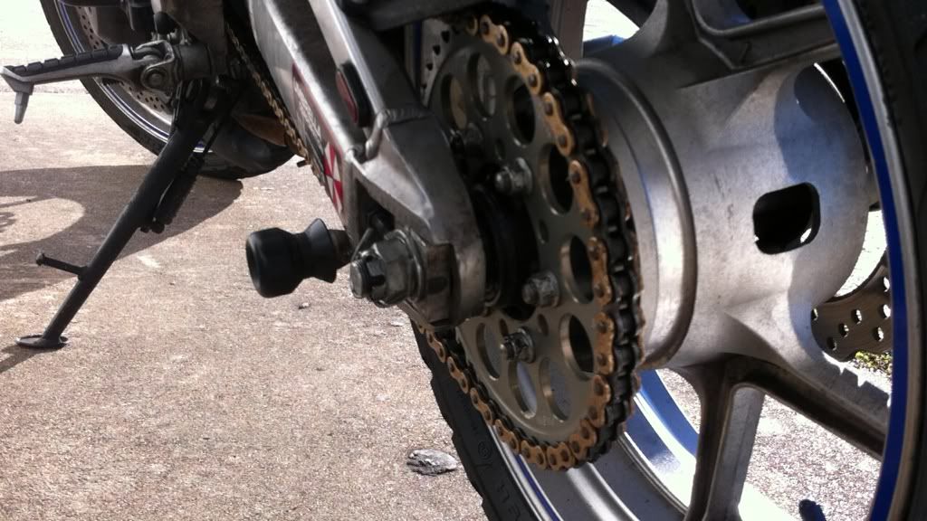

Just got done doing my 15,000 miles service. I put new plugs in (NGK CR9EIA-9), and while I was there I removed the sub-throttle plates, and the snorkles from the air box. I replaced the front sprocket with a new 15-tooth JT Sprockets Steel Sprocket. I replaced the rear sprocket with a 43-tooth Sunstar Triplestar (I ordered a 44 but they sent me a 43, and I'm impatient so **** it). I replaced the chain with a 140 link, #520, D.I.D. Gold X-ring chain with my new chain tool (first time I've done that, so I probably did it wrong, but oh well) Installed another AM44 (H compound) Avon Distanzia rear tire (160/60-17). I also changed the oil and filter.
I'm not quite ready to buy a shim kit or a feeler gauge to do my own valve inspection/adjustment, so I dropped my bike off at a local bike shop to let them deal with it. I put a little paint and a piece of clear tape I wrote my name on, on the backside of the engine/valve cover joint. I'll check and see if it's broken to at least see if the engine was opened or messed with for my 225$ (3 hours labor @ 75$ an hour). This is my first time actually letting someone else touch my bike for service outside of tires, and I'm a little paranoid about getting a service done that you can't really tell has been performed. Supposed to pick it up again tomorrow.
Here's my bike when I dropped it off...

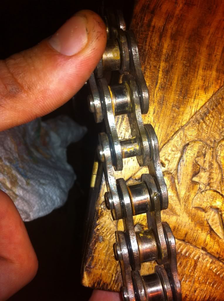

Oh and here's my old chain:
Broke a roller off on a link. Thats one of the reasons it was so loud.

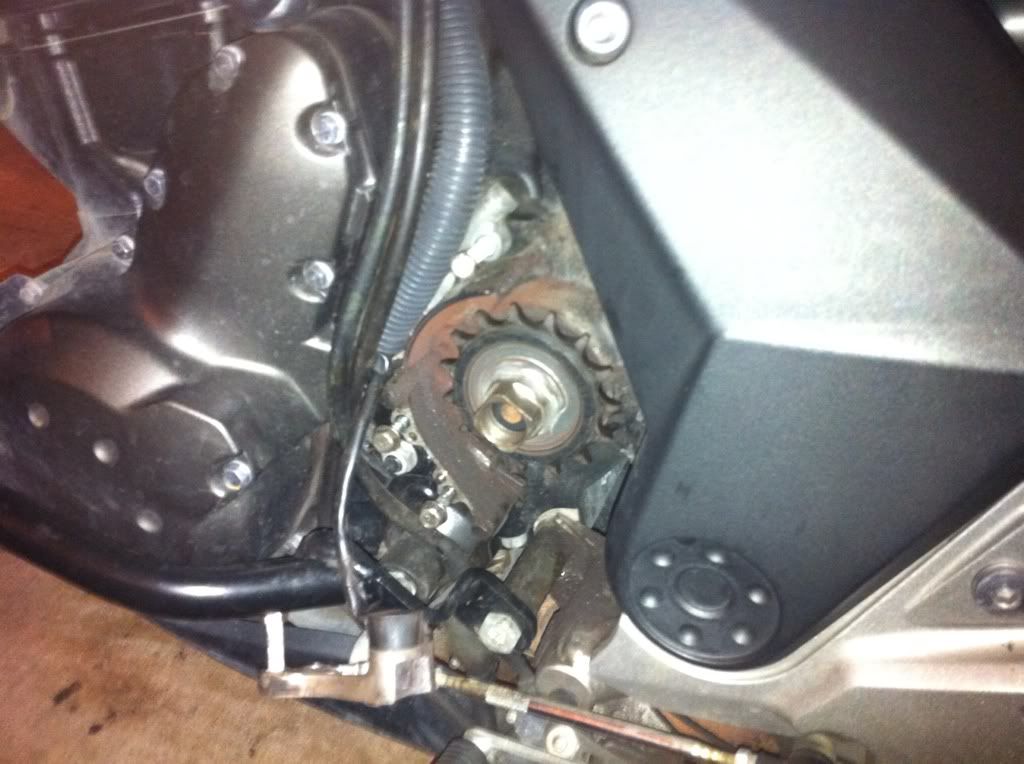

Pics of when I was doing the work.
Old Sprocket
Flattened out the lock washer completely, couldn't break it with a 36" breaker bar. 1/2" Impact with 27mm socket took it off like nothing though.

Here's my bike back out of the shop:
