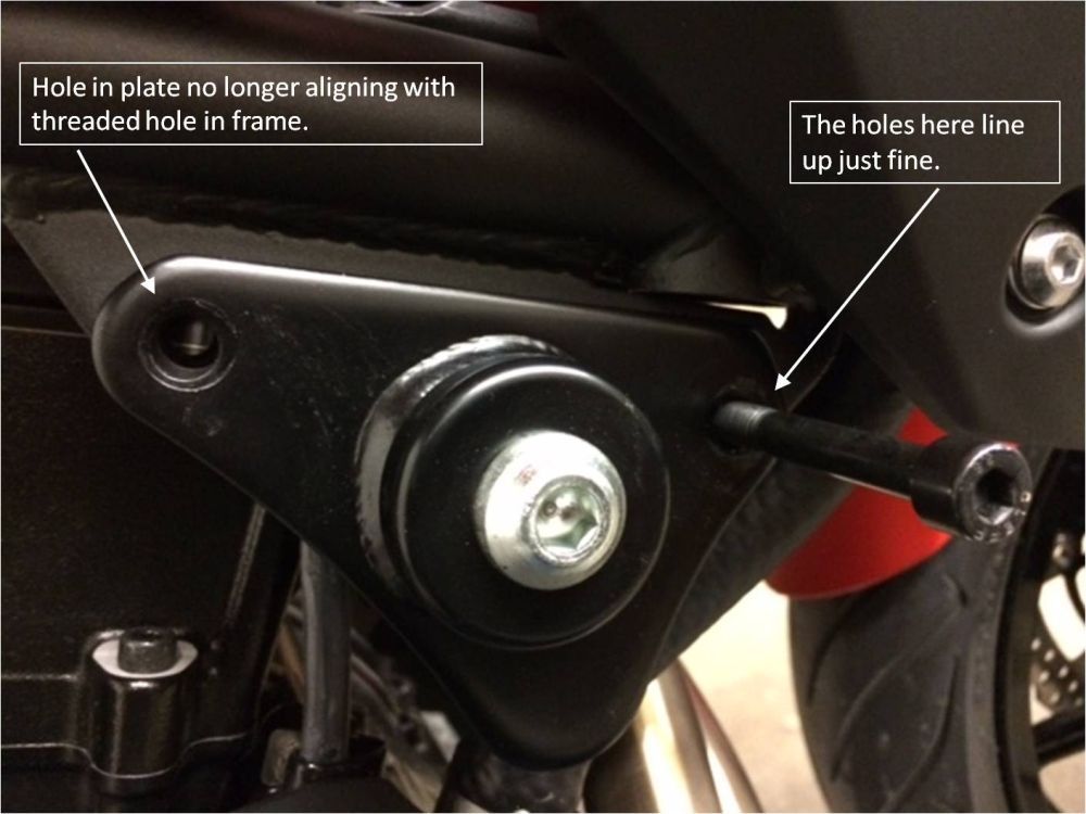

Just got the bars for my 2016 650LT. The installation seemed simple and straight forward. Started on the right side. Took out the original bolts from the plate seen below. Tried to mount the bar and could not get the left bolt to catch the threads. Look in in the hole and saw that the hole in the plate and the threaded hole in the frame are misaligned. I noticed when I was removing the left bolt that it seemed to be a little hard to lossen.
This is a big problem as I can't even put the OEM bolts back in! Anyone have an idea how to get the holes aligned???

That wouldn't work because there is a nut tacked to the back of the frame where the bolt goes into. Not enough room to work with a file.

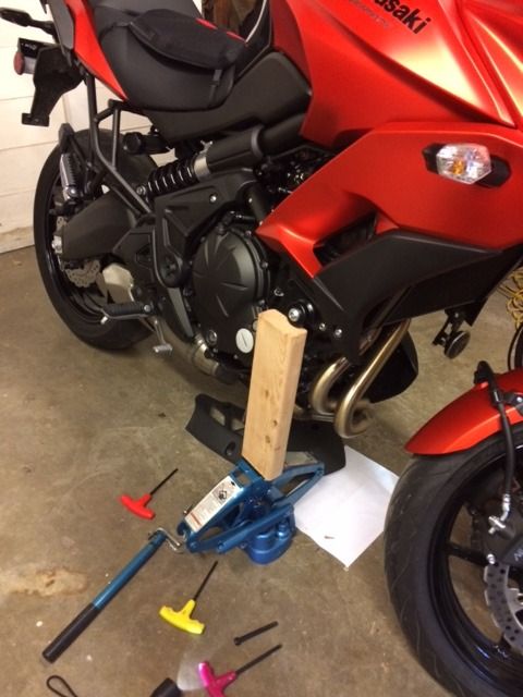

I did finally manage to get the bolts in. I had to jack up the motor mount to get the holes to align (see pic):
You faced my most anticipated problem! Congratulations.
When removing the bolts, I was lucky enough that some friction was holding the engine up and the bolts were free. But a simple nudge could have brought me to your situation (and I don't have a jack).

Looks like "gentle" support under the engine before starting is the answer. (Can't remember IF I did that when I mounted the SW-Motechs onto my '15 650LT, but I had NO problems!)
I only did one side at a time. Did you try doing both left and right at the same time?
