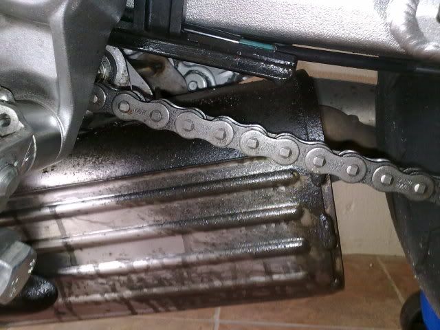

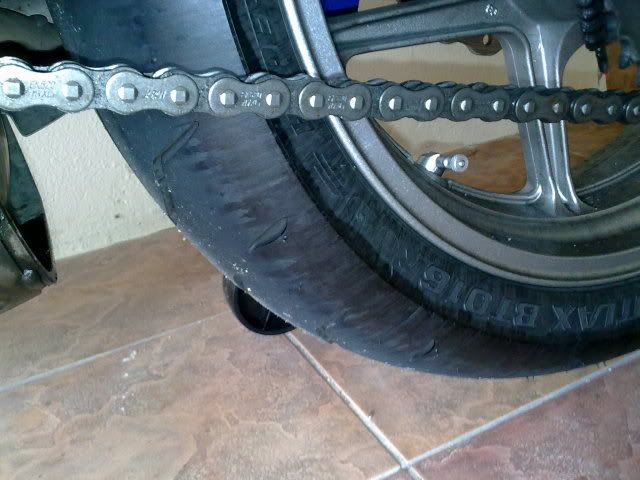

Posts: 7,130
Over lubed by Auto Chain Lube system.My Mistake of setting on high dose.
Just be careful with automatic Chain lube systems.
post #11 of 22 (permalink) Old 07-28-2010, 01:29 AM Thread Starter
Posts: 195
oh boy! Mine wasn't even 5% of that...that's a tone of lube on your bike. I hope you didn't skid on that tire.

Posts: 7,130
I was just on 3 drops of Chain lube per KM and see the amount of oil on the tire and muffler. I was going out and the chain was a bit dry so set it to 3drops and went along till the back was funny on corners. Stop and found this. was a slow ride back home. It was my mistake as I usually set to 1 drop if the chain is dry.
Most of the time I will spray oil the chain before ride and the Oiler system is only for long tours where it comes handy.
