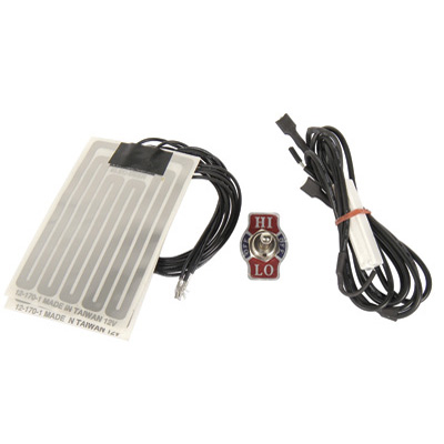

For $4.19US/$5.23CDN you can get a kit like this from EBay. Recently saw a friend's bike where these were installed. They install over the existing grips and then are covered with the included shrink wrap and bicycle handle bar tape. Surprisingly the install looked fairly clean.
One caveat is the Oxford grips are rated for 50W and 70C/158F (against gloves) on high, however these however are rated for 20W so I would not expect them to provide a similar amount of heat.

I thought I would risk trying these due to low price. They do get fairly hot with an integrated switch that has two temp settings. The wires appear kind of thin for the current draw though and require lengthening and soldering. The right grip has an integrated throttle tube and cam that does not work with the Versys, at least not without lots and lots of modification. I discarded these instead of trying to get them to fit.
