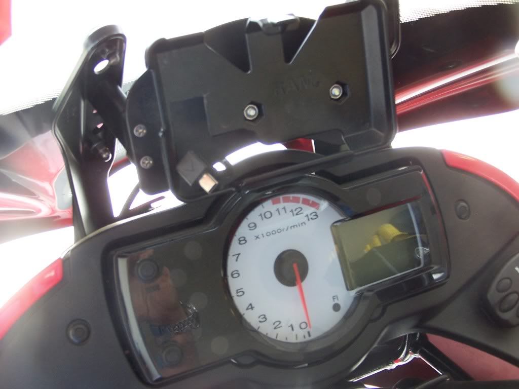

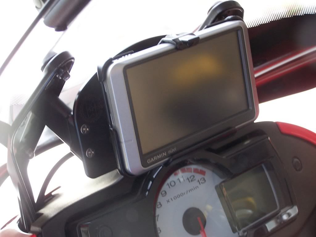

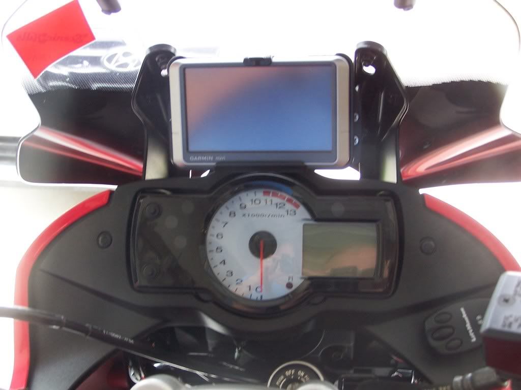

Ok...got it mounted. I had to angle it a bit and hopefully it doesn't look too silly, but the antenna on the GPS had to at least be to the side. There was no way to get it to go up without adding spacers to the mount so we'll see how well it does triangulating. I only had it on a moment to take the photo and all seems fine. I'll know more after the next ride.
Now I need to get the powerlet in the fairing. I'll be using this one.
No one ever said farkling was cheap! My mirrors should arrive tomorrow as I totally agree with everyone on the irritating mirror vibration. Next is the heated grips and I'm good for a bit!!
Here's the mount.
With the GPS
And my very green bike all cleaned up! Now, where to go...

Certainly looks good to me.
I hadn't taken the antenna into consideration in my mounting comments, but it looks like it turned out just fine. Also looks like the weather in Sacramento is fine as well.
